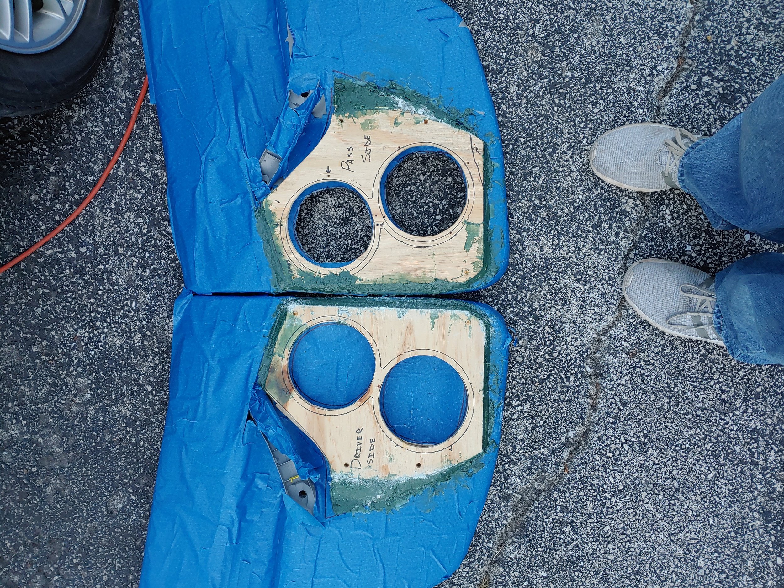

You can see that I have a before and after shot. There was a single 6.5" midbass in the factory locations. There is some non hardening modeling clay surrounding the driver on both the front and rear of the baffle amounting to about 4 lbs. Now my expectation and hope was that this was good for mildly higher temps but what I have found is that there was a small amount of oil that sweated from the clay and made a hug mess. When I used the cheaper **** in my Malibu (previous build), I had no such issues; though the car did have a permanent smell of wedding cake. Mostly amusing.

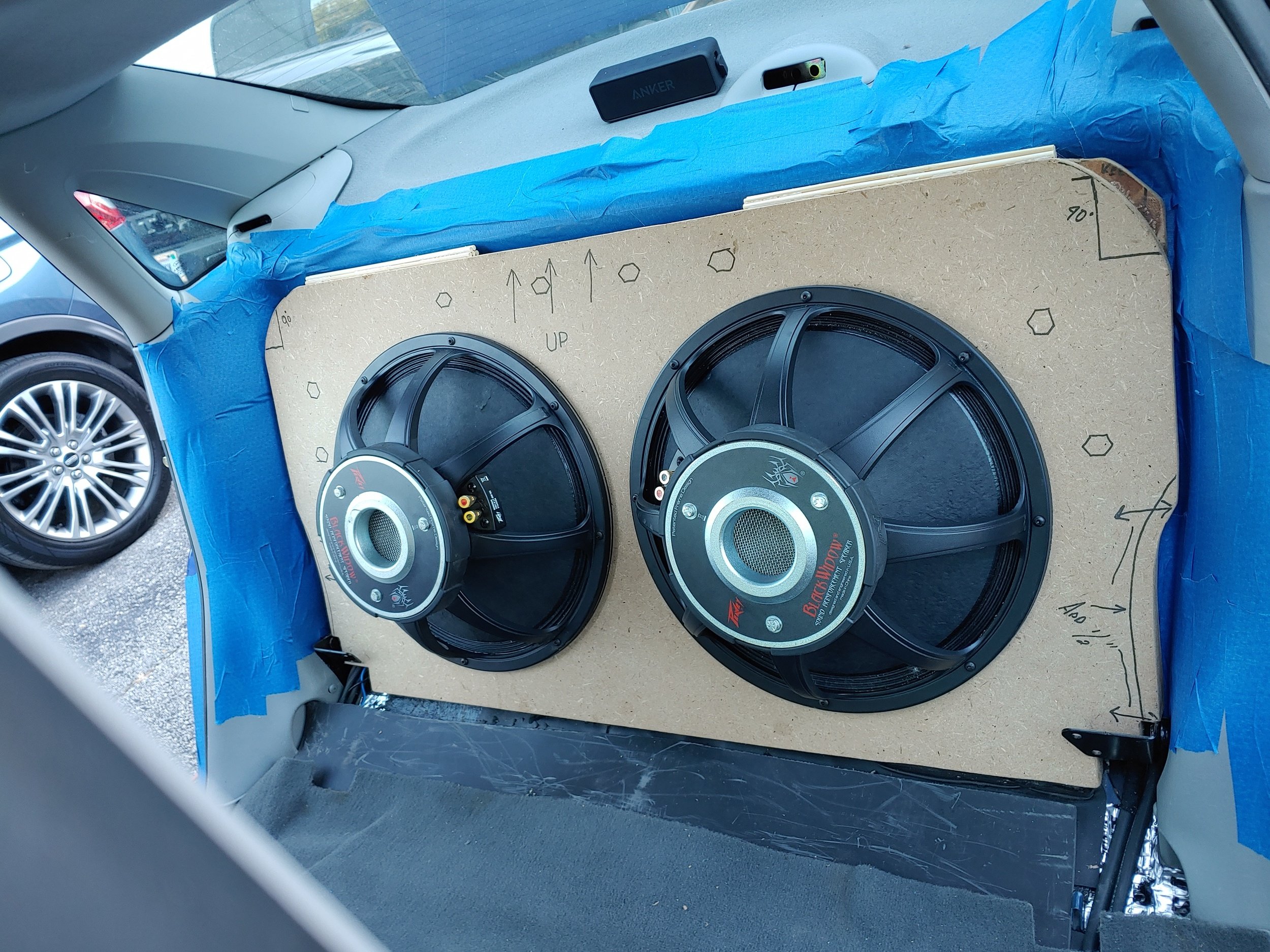

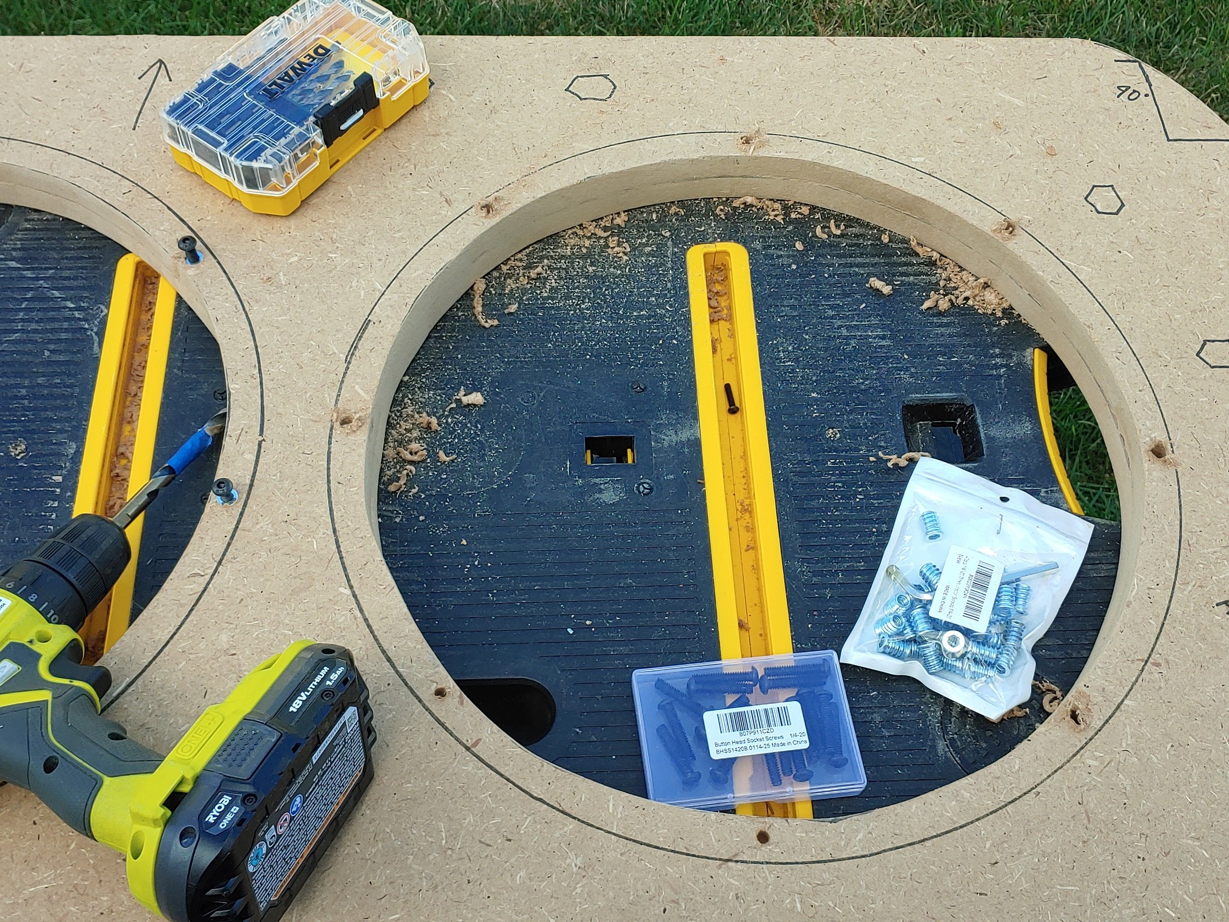

Not to spam but I needed to start another post as I have a ton of photos to share. To begin I took some 1/2" baltic birch and made some light weight baffles with a few smaller pieces added to the rear for strength and add'l depth. The drivers I am using are 3 1/2" deep. They are the glass fiber Daytons that I showed in one of the previous pages. I am a huge fan of Dayton Audio and I suggest you check them out.
In the first phot you can see the holes I made in the door panel to accomadate the drivers. I will need to enlarge these slightly as I learned when reinstalling the drivers on the installed door panel.
Some further shaping of the panels will be required but I will address that a bit later.

You can see doing some hasty measurements That I have the depth but when I attatched all the door hardware I noticed the upper driver is making contact with the sheetmetal at the factory speaker location but its nothing that a jigsaw and a metal blade cannot fix. Fortunately for me there is only a small section of the motor of the driver making contact with the door. like maybe 7 sq. in. :)
You see I am on the fence about further shaping the panel but I believe I will sleep on it since there is still a good deal of work that I will need to finish the panel.

Once the first layer of reinforced filler is applied on the outside we can apply a layer of milkshake. (resin/bodyfiller mix with catalyst) to the interior surface to further strengthen the panels. I've never been proficient enough to build super pretty but mine are always bulletproof.

So I'm back with a few more photos. I made a mistake but rather than hide it I figured I would show you today then return later with the repair. In my haste and after about 6hrs working non stop on the car I made a mistake; albeit just an asthetic one. I drilled the holes so the alignment of the subwoofers is incorrect. I was so wiped I didn't even notice until I looked at the drivers mounted.
It's not a big deal and a quick fix so I'll eat my crow and fix it tomorrow. You guys know me I post everything. Total transparency boys...In any case I want to run the wiring closer to the upper center section of the baffle hence the orientation. I have some grommets on order so that the wiring will travel through to keep everything clean.

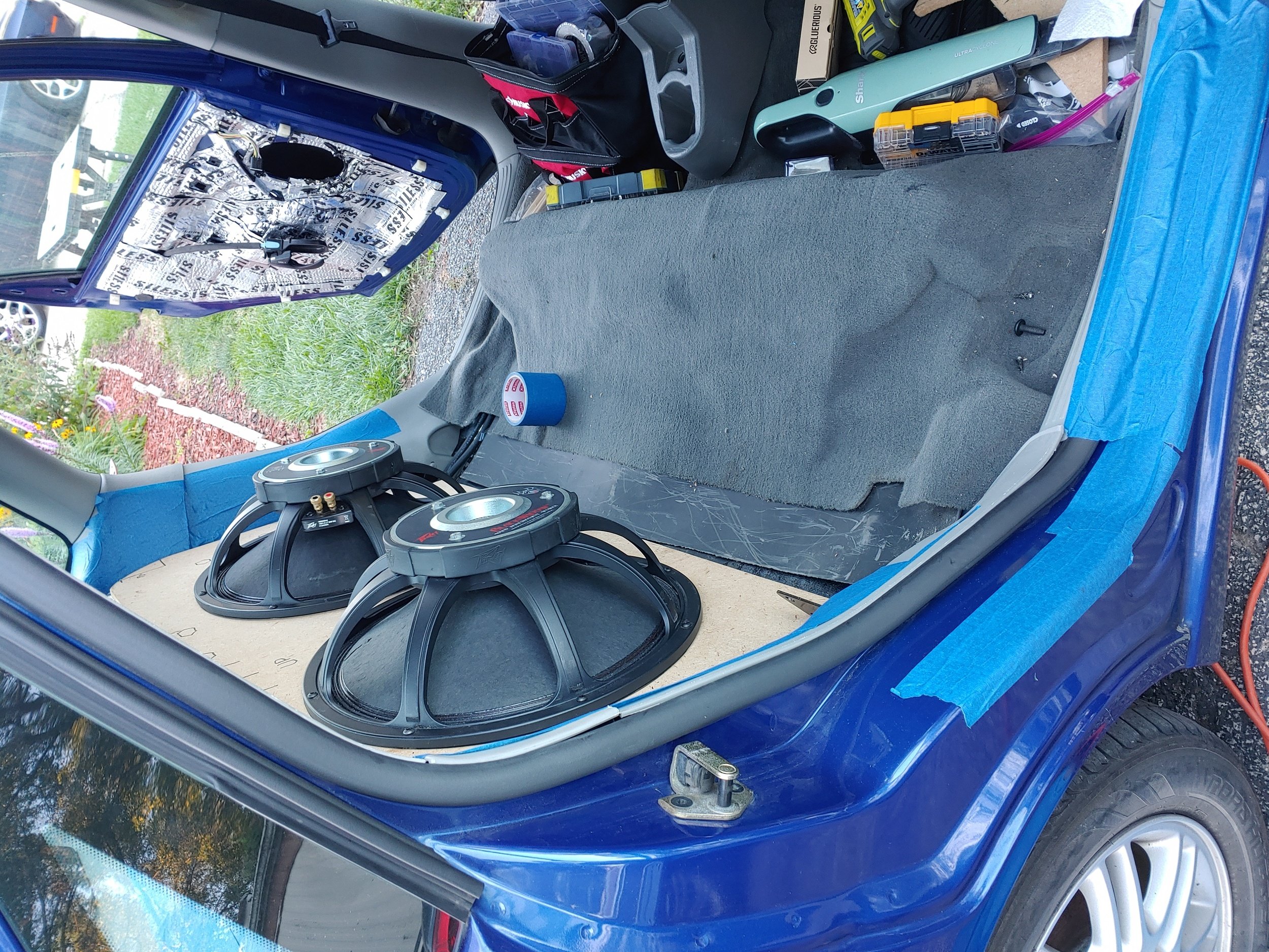

Why did I mount the drivers now? I just wanted to see what they would look like. It also felt as a landmark was acheived. The fact is though were still miles from me wrapping this monstrosity.

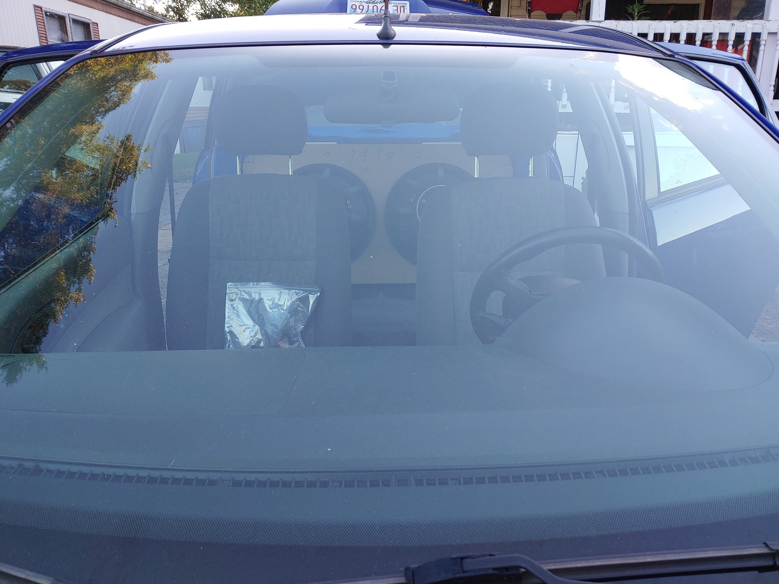

As you can see there is a significant amount of the rear deck area that is taped off. There is also wooden dowels that have been glued to the baffle. This is the beginning of me filling the gaps before I glass them. Whenever I have a glassing project I like to get all the projects that far that way I can do them all at once. Since I was working on the doors I figured two for one.
From the pictures you can see there is a gap inbetween the dowels. This was deliberate. I am building a brace that willl go from the baffle to the ceiling/roof. Kind of like a stripper pole. Looking from the trunk there will be another brace so It appears to run through the entire car. I know it's hard to wrap the idea around your head but when I make some more gains in the fab department it will begin to make sense.
