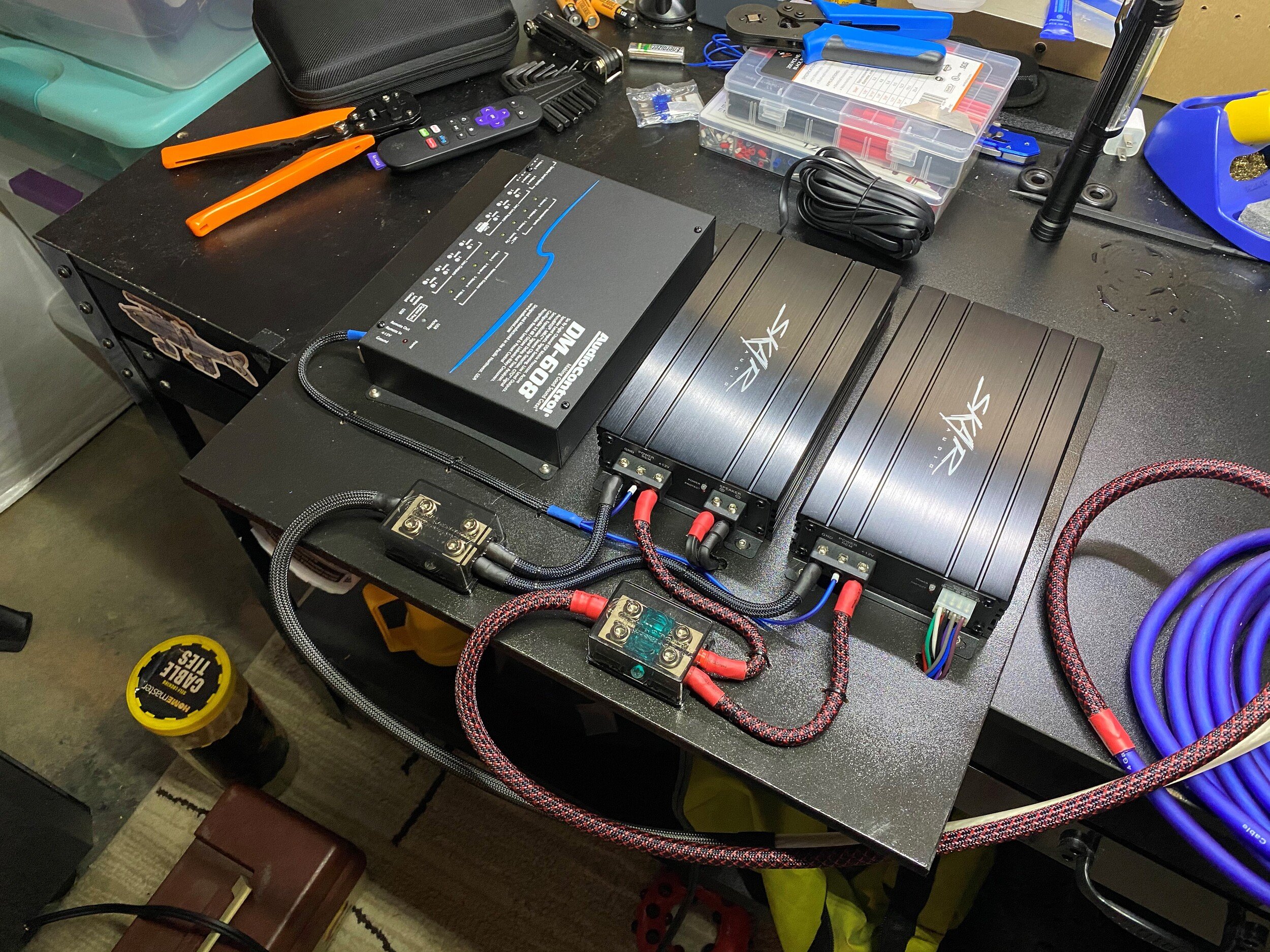

Made some progress this weekend on the Taco. Built my amp rack, sound treated the back wall, and ran the 9 wire cable ill be using to connect the factory HU to the DM-608.
Amp rack build pics. Pre paint and Finished. I took a page out of Dean from 5 Star Audio book for the amp rack. I really like how he wires up everything so I took the time to mimic for this project. I really like the outcome.

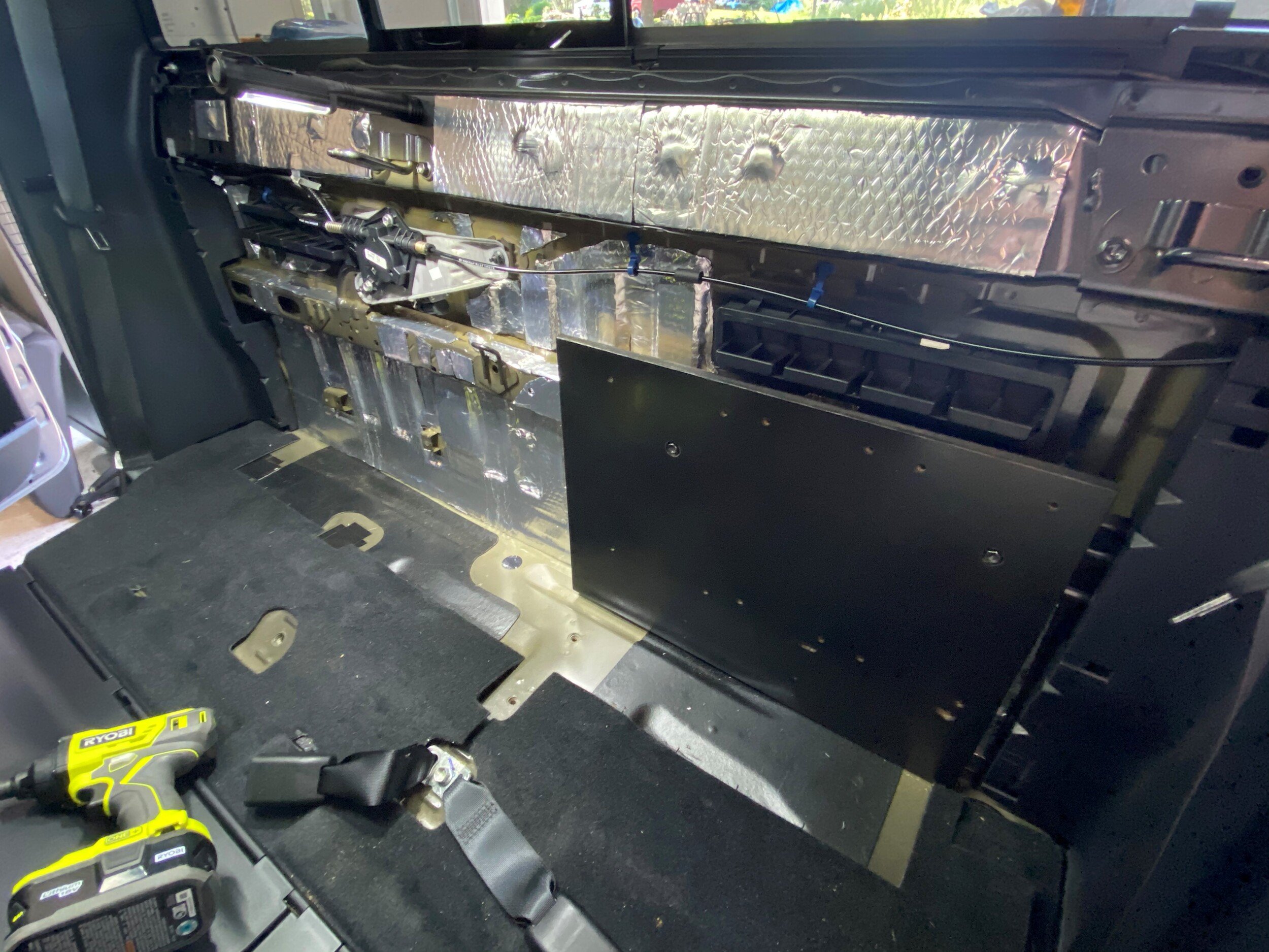

Amp rack fit testing and Noico 80mil sound deadening on the rear wall.

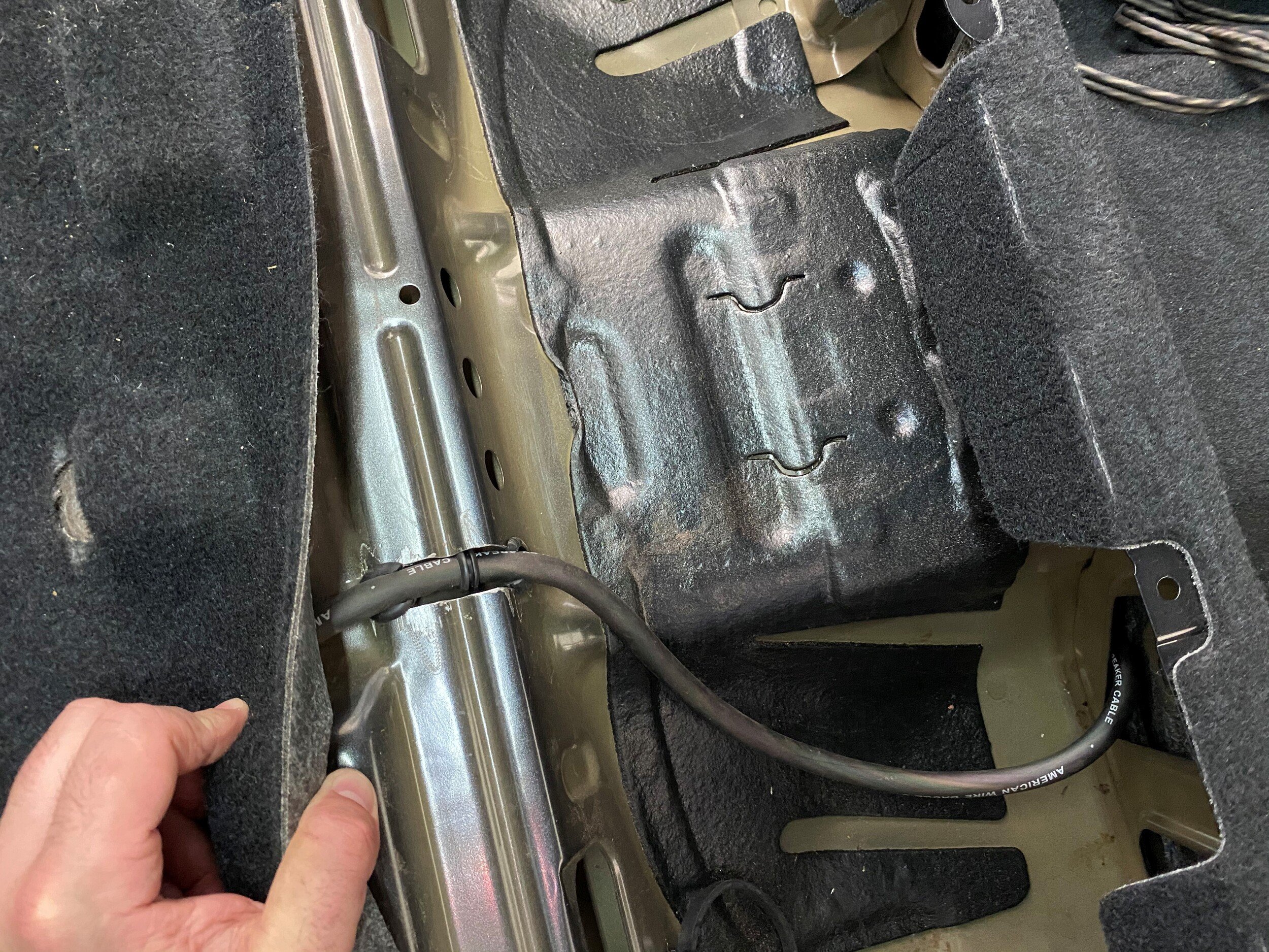

Finally, the 9 wire cable run from the HU to the DM-608. I took out the under seat rear storage box and ran the cable up the the passenger side of the center console. I had to Dremel a notch out so that the storage box would sit flush again. I used 3 grommet's from a Harbor Freight kit to make sure the jacket is protected. It worked out pretty nice in the end.

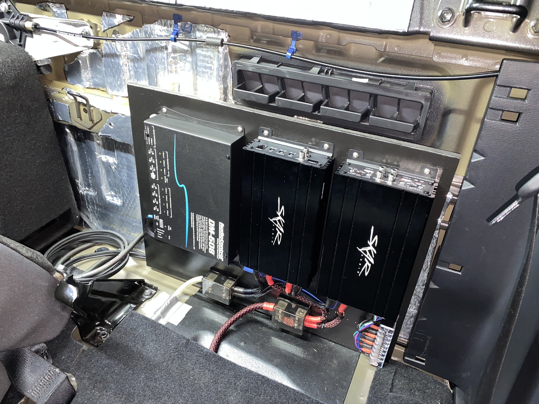

More progress made. Amp rack is mounted. Just need to run speaker cable off the 8 position terminal block up to the existing cables under the driver seat, connect the speaker level inputs and run power and ground for the DM-608. Also waiting on some short RCA cables from KnuConceptz. I went with the Karma V3 for this project. Don't need the super high end stuff for max 3ft run and these look puuurty anyway.
I decided to get everything tuned up with the existing Kicker C67's in the doors and wait on installing the component set. I want to tune this set up and see how much of a difference there is. With the LC7i and the Pioneer amp, these already sound great and I'm certain the DSP will pull it all together. I may end up deleting the passive x-overs and keeping the pioneer in to run the tweeters off 2 of the channels, but I'm going to play around with each configuration and see how they turn out.
23506
23507

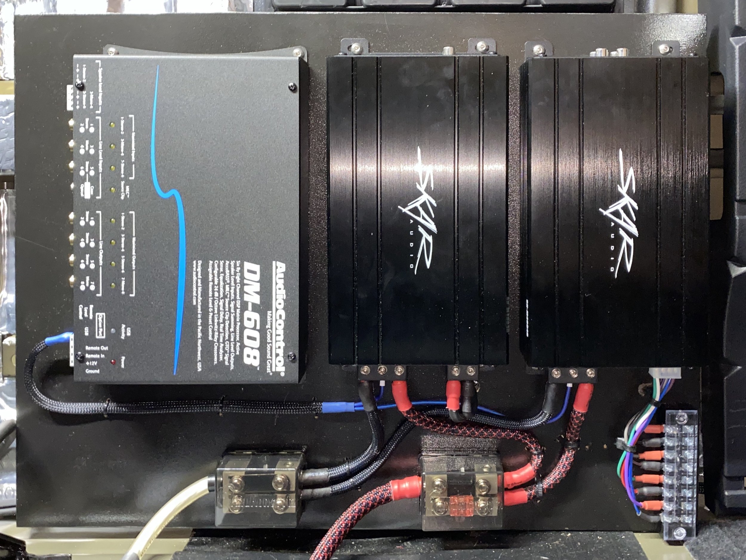

Well its all installed. Spent from 4pm to past midnight yesterday finishing up everything and replacing the CCA speaker wire I had run to all the doors for the initial project with some OFC 14 gauge Kord cable from KnuKonceptz.
The battery terminal is a KnuKoncepz Bassik Positive Battery terminal. With the extra battery post. I'm really happy with this product, especially how the stock Tacoma terminal post fits nicely. Plenty of room to attach ring terminals for amp wire.
The fuse block came with my Skar 4ga amp kit and I made a mount out of ABS and used existing holes in the engine compartment. I got this idea from watching Fernando from 5Star Car audio.
The distribution blocks are also KnuKonceptz 2 Way 1/0 to 4.
I'm also replacing the RCA on the sub amp (middle) with a 3ft KnuKonceptz Karma V3 like the other two. I thought I would have enough length with 1.5ft but that clearly didn't work out.
I'm still waiting on my JL Audio StealthBox with the 10TW3 to come in, but for now the old Kicker 10" will have to do.
The worst part so far is that after I got it done last night I was too tired to mess with tuning the DSP and setting the gains on the amps, so I had to drive to work today with the system sounding like dawg skat. But even with it not tuned properly, it still sounds decent enough. I used the auto EQ and summed the channels. The real fixing will come over the next few days.
I feel like despite the entry level Kicker drivers I have that I can get this system to sound relatively decent. I mean I hope so, cuz I got some CC bill to pay off now 🙃
