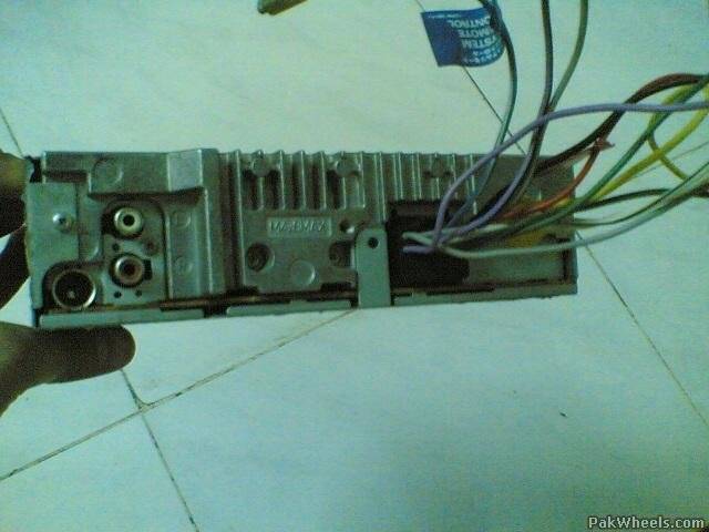

I have an old car stereo - Pioneer DEH-2750MP - bought in 2005 and it is still working without any issues. It has only CD player input and no 3.5mm aux input nor Bluetooth input. I'm planning to add at least 3.5mm aux input.
I haven't unscrewed it from the car so I don't know how it's rear looks like. So I searched for the images on web and found some (see attached)
I read somewhere that the RCA jacks behind the player is called preout-rear. I don't know what does it mean. So I'm asking that can we connect a '3.5mm jack to RCA' to this RCA port? Or is there any way to attach a 3.5mm jack to this player?

Doubtful, and really these days you could probably buy a discontinued model of something pretty nice for short money anyway.   Really 3.5mm headphone jack has always been a very poor source, prone to being noisy and all around low quality.   I would highly suggest figuring out a different method to plan around.

I have one more question that what is the use of that RCA port? Can we just directly connect any RCA to 3.5mm adapter?
Thats an output port, useless for anything you are thinking of.

Those are always a very weak link.  Use a head unit that can get audio via USB or Bluetooth.  The 3.5mm jack is designed to power headphones and if you amplify that signal beyond that half a watt or whatever it almost always introduces distortion/noise.  Really a head unit that old is completely obsolete by every measure.
