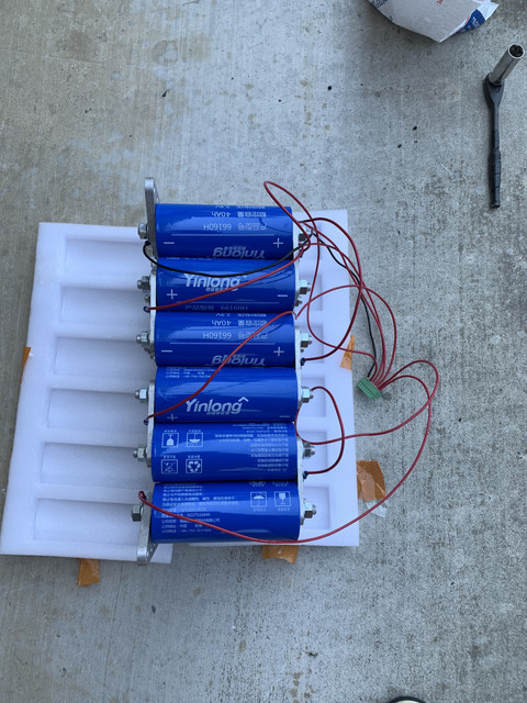

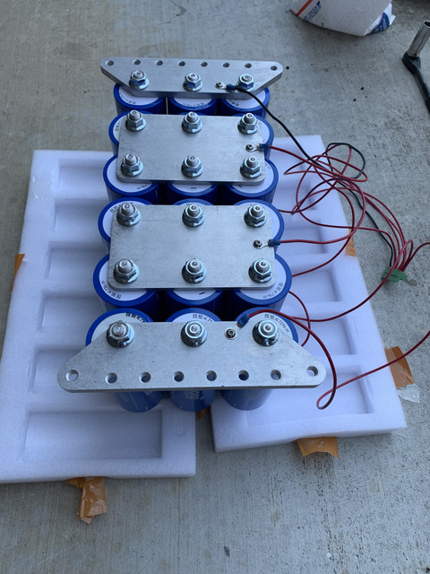

Our DIY LTO build log here:
https://www.caraudio.com/threads/lithium-titanate-lto-battery-bank-build.600099/
