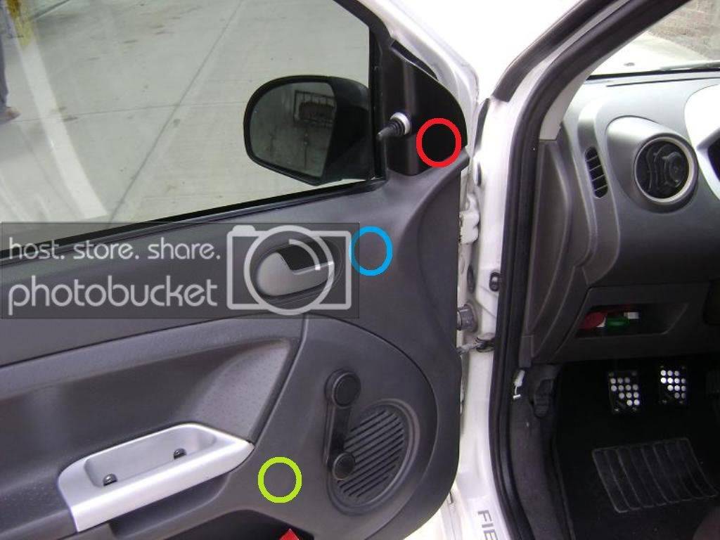

I was just wandering what you guys think is the best place to mount tweeters, I know ultimately the position of the tweeter can be very different in every car that's why I showing a pic of my door, in the A-pillar, on the rear view mirror pointing right at the passenger and passenger tweeter pointing at me, next to the door handle or closer to the midrange?
I've read to mount the tweeter closer to the midrange speaker lower on the door but my door doesn't have to much available space and the spot where I put the yellow circle is too close to my legs, but on the other hand, I've always been told to have the tweeter higher up so it's closer to your ears instead of pointing to your lap (unlike the midrange speaker).
this will be my first speaker install and i want to take the time to make them sound the best they possibly can, so what area suits best for installation and why.

what car is this? I think it'd be closest to your head in the red circle depending on how big your head is. Red circle would also be the easiest to install it because that sail panel is already angled.

the car is a small Ford Fiesta HB 2005 (looks like a Honda Fit in size and interior space)
the tweeter is a Focal access 165a1 comp set
and the sail panel is not really angled it looks angled only in the pic but is pretty much flat straight
i've installed tweeters in each location you identify (in various vehicles over the years). green is easily blocked by knees. blue means you permanently de-value the car. red lets you replace that part later on, but since it has the mirror controls in it, you might not be able to use that location. why are you set on the doors? where are the crossovers being mounted?

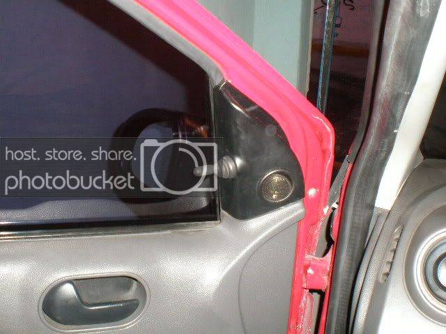

well as you can see in this new pic RED location can be done even with the mirror control, some friends with the same car had done it before but I just wanted to ask you if that a good location for the tweeter
