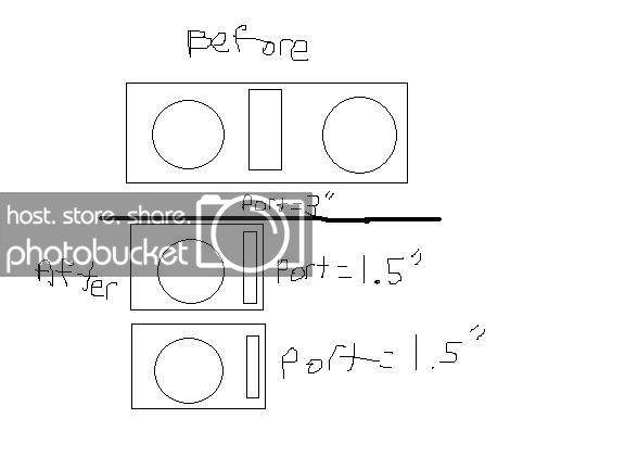

I have two 12" atlas, in a ported box. The port is in the middle of the two woofers...
Would it be possible to cut straight down the middle of the port, and slap two 3/4 MDF on the edge where i cut to make the port virtually the same size as the two ports that come together? Lets say the box has a 3 inch port, I will basically be making two 1 & 1/2 inch ports.
The reason I am doing this is so that I can take my boxes out from the trunk like a normal box because I had to take the backseat & frame out to put it in the trunk. I cant access my spare tire with this big box in there so there is no point in putting backseat back in...

MSPAINT FTW LOL
because you are adding a piece of wood thats .75" thick and will take away the port volume and change the tunning and such i think that would be why
i am not sure though
Im adding it to the side, the port would just be cut in half, making two 1 1/2 inch ports??????? it would make the box itself .75" wider but keep the port sizes the same
It'll work just fine, but yeah, it'll be tuned 1-2hz higher. You do realize though, if you already used the max width in your trunk, it's going to be an inch and 1/2 too wide, right?//content.invisioncic.com/y282845/emoticons/tongue.gif.6130eb82179565f6db8d26d6001dcd24.gif
yep, width is no problem. I have give or take 5 inches.
