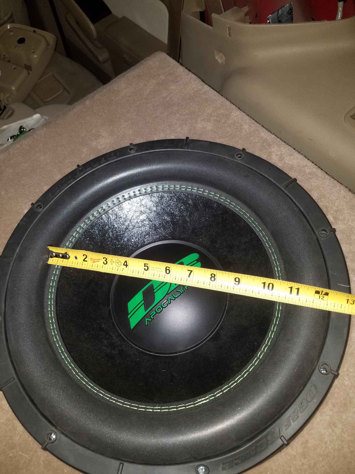

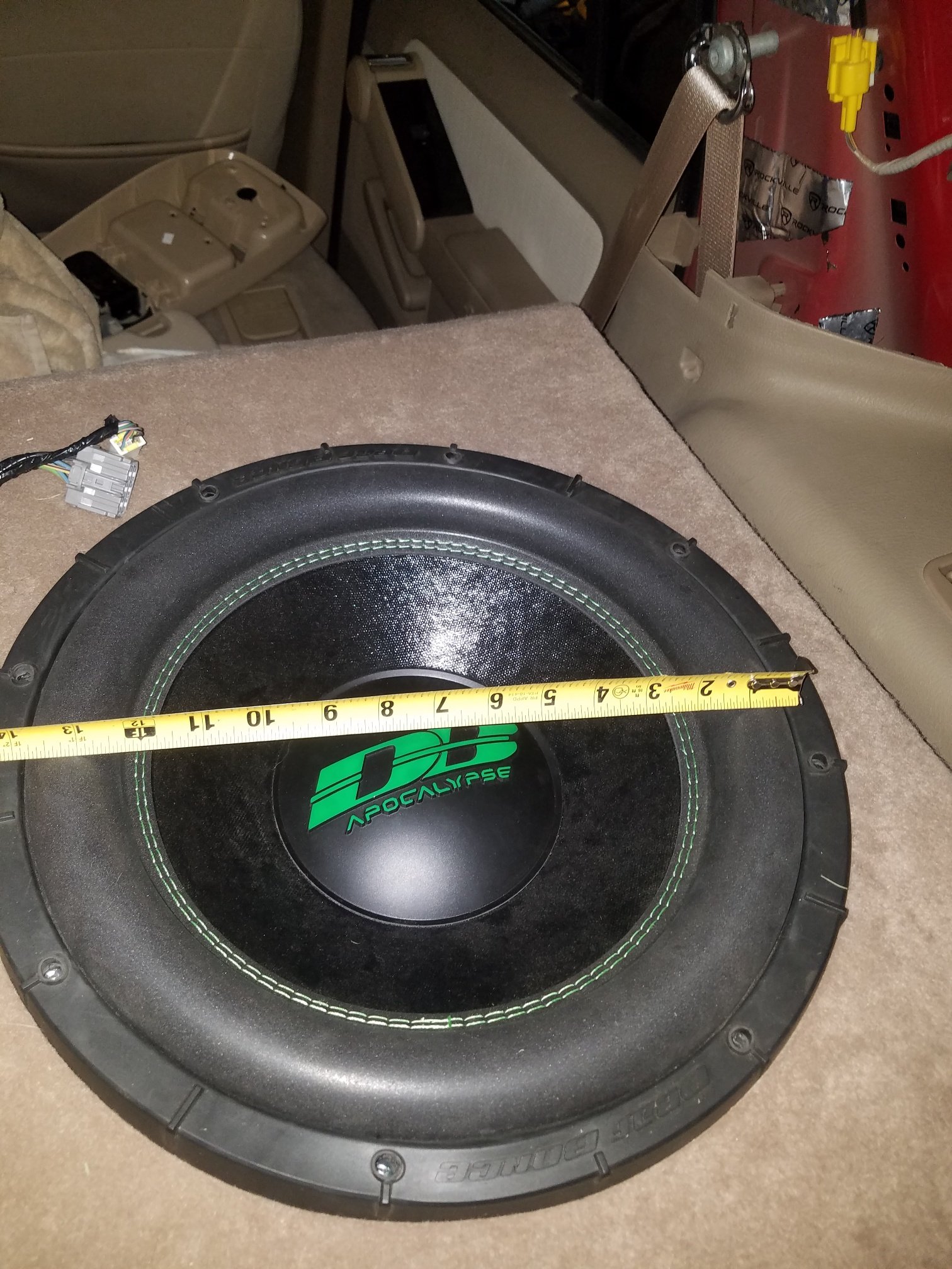

My Deaf Bonce subs are listed as 15's, but they do not measure 15". The cones measure ~11" in diameter, and the surrounds measure ~14" in diameter. Cone area is pretty important in this game, so I'm curious how different brands stack up.
Mostly because i have diagnosed OCD, but also because some competitions set classes based on driver size.
A 15 whether its smallish cone-wise will be 176in2... you ever see judges out there pulling measurements on the cone splitting hairs over surround size?

I'm happy for you with regarding your purchase. Surround size is something that is accounted for in any speaker. A 15 s a 15 whether you have 130in2 of Sd or 160in2 of sd.

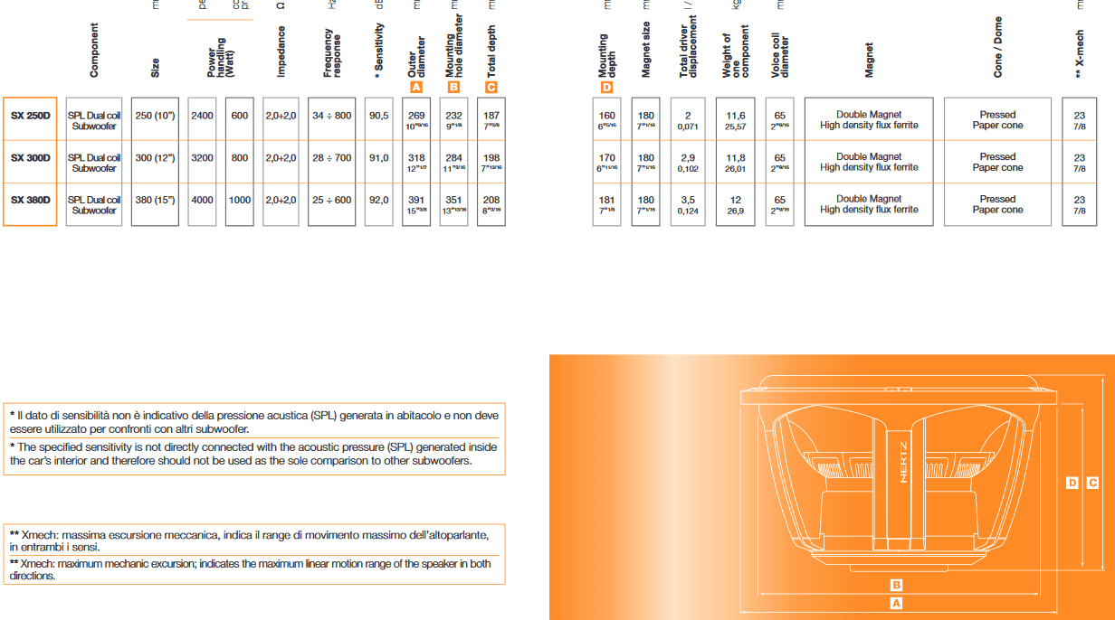

You can always check out the manuals. Here's mine, the cone is ~13.82in or 351mm. The only thing (kinda) standardized is the ring diameter and mounting hole. Even those can vary a little bit.
