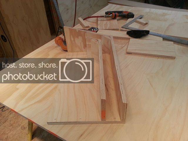

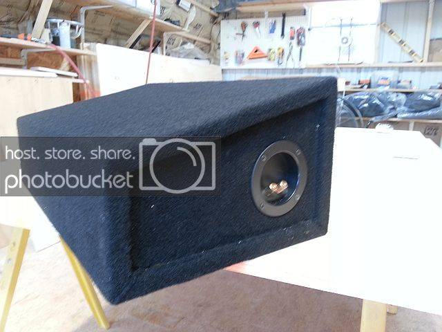

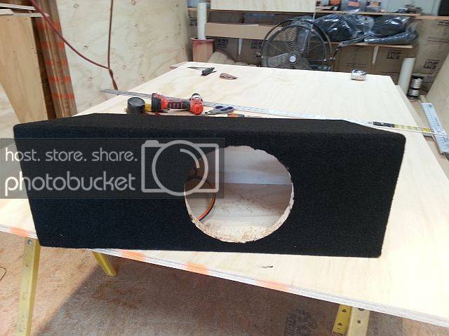

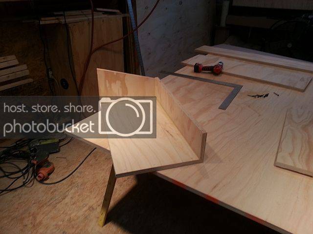

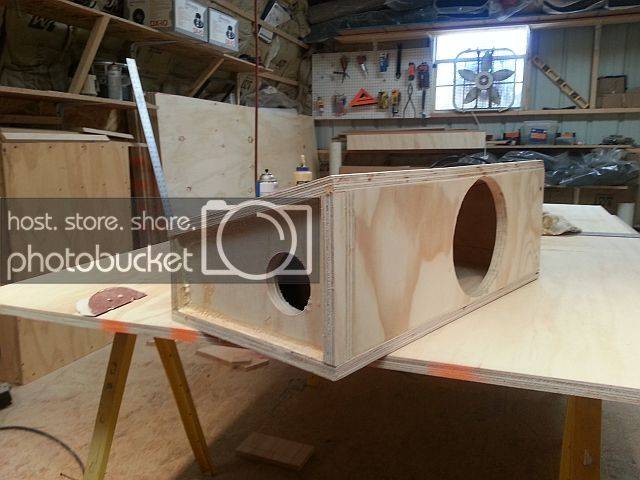

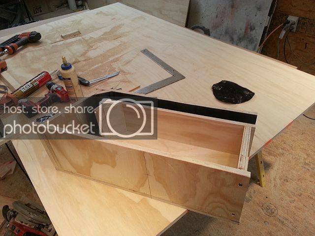

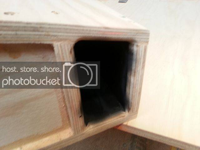

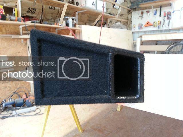

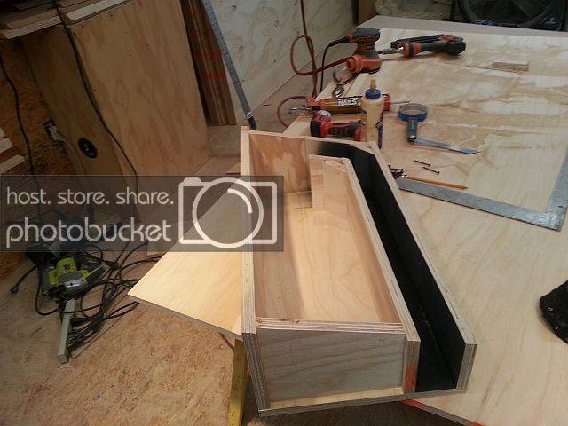

This is for a single SA 8"........35hz and .75 cubes net.....Arauco construction.....flared mouth slot port...
