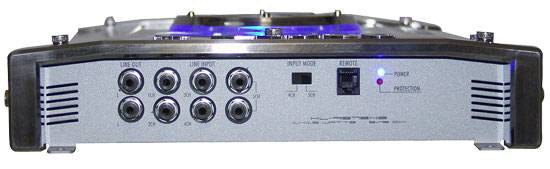

i need a link to the owner's manual, or access to one in order to tell you definitively how you need to hook it up. i'm glad to help. i would look it up, but i don't have a model number yet. //content.invisioncic.com/y282845/emoticons/smile.gif.1ebc41e1811405b213edfc4622c41e27.gif even good photos of the side controls (both sides) would help.l

from the amp images you can see that it has an input mode setting for 4ch or 5ch. you'll use the 4ch input mode.
you will need a 4 channel Line Output Converter (LOC) or two 2 channel LOC's.
