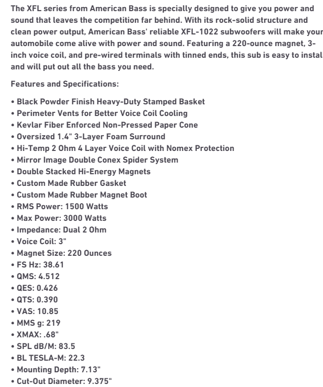

First off as the title suggests I'm new to doing any builds of my own. I've loved bass and car audio since I can remember, started DJ'ing underground raves and clubs when I was 13 but never had the money to do anything like that for myself. Now I'm 41, have a family I support but also have a great Job in IT I started 4 years ago and can put some money into the car audio now. Plus the wife appreciates the fascets of the building/installation process and is very supportive of it (my wife is an amazing woman).
So I currently have a meager system in my mid size SUV. Boss BV755B head unit (I know but was on a budget and it's serving it's purpose lol), Front doors (about to put them in) Skar VX200-ST | 1.8" Bullet Super Tweeters and Skar FSX65 6.5" Mid-Range Loudspeaker, 1 each in each door. Backdoors, Skar TX4 4" 120 Watt Elite Coaxial Speakers (just finished modding these in the doors), Kenwood KFC-1666S 6.5' Coaxials, again 1 each in each door. Started with a Rockville RXD-M3 Amp for my subwoofer and eventually upgraded to VFL Class D Monoblock Stealth Max 3000 Watts Amp. Finally my subwoofer is a 10" American Bass XFL Dual 2 Ohm VC (this is the 1500rms/3000peak version), in a prefab Rockville RQB10HP. Again, my first build of any kind. It's been 20 years since I knew what was good or out there. Allot has changed and some things drastically.
I had a friend in 2001 who had 2x 15' Kicker comps in his blazer, no special box, that just hit your chest and throat like mad lol. Want to get some of that feeling (not completely though lol). I'm still amazed at the XFL 10's performance but doesn't quite hit the lows like I want and I also want a little more punch in the chest like I said earlier. At first I thought of upgrading to a 12 and keep it around $300. What I found in my research that fit the parameters are Soundqubed HDX3, Resiliant Sounds Gold series, SSA Icon, AB XFL or HD (but thier Fs is kinda high and worry about not getting those lows), and the Skar VFX. I don't want to go any higher in watts for the sub than I already have and actually a little lower would be nice so I can put 60-100 rms to each of the front doors. Obviously, a custom box will be in order as well. I also wondered if bumping the size up to 15" instead of 12 is do-able, I have the cargo room. Or would it be better to go 2x 12 that total around 1500 watts rms be the best route?

Really? Ok, dont think I need to go to 12” XFL? Any advice on what to request or certain specs i should provide when either hetting it made online or plans/cut sheets for me to build myself?
One of the issues I’m finding with this is getting the correct parameters for my version of the XFL. You’ll almost always see the 1k watt rms version and mine is 1.5k watts rms. I imagine that changes some things.

I would suggest that you sell your 10" and get two XFL 1244's and run them at 1 ohm with your current amp in a custom box tuned to 32-35 hz. I think that would give you the bass that you are looking for.
I don’t think you’ve heard what that sub can do in a proper custom ported box. If you can power that sub with a strong 1500 watts and have it in a custom ported box, it will get downright nasty. Whatever sub you go with, just do a good box for it. A good box will make a 30$ sub sound great. A bad box will make a 500$ sub sound like 30$. The boss head unit would be my second upgrade, after a new box. Any head unit with 4+ volt preouts and an EQ would be decent. My third upgrade, if I had your equipment, would be to sound deaden your doors. With all the extra bass you will have from your custom box, you will need to get some more midbass to keep up with the subs. Sound deadener will help any speaker sound better and get louder in your doors. First time I used deadener in my doors, I was shocked at how much better my door speakers sounded. I had planned on new door speakers, but with deadener, I kept with those speakers for 5 years. Big difference. After you get a good install finished, you can start swapping out whatever equipment you want with good results.

I would suggest that you sell your 10" and get two XFL 1244's and run them at 1 ohm with your current amp in a custom box retuned to 32-35 hz. I think that would give you the bass that you are looking for.
I’m already running right 1 10 at 1 ohmo. To the yeeter yyeeyeyeeyyee and the Sundown efgufpm of k

In my post, I did say space wasn't an issue. Sorry if I wasn't clear enough. I plan on a custom box next but I'm showing the suggested from AB is 1-1.5 sqft. I was thinking the same on the size and bumping up to a 12 XFL in a custom box. But if I was able to get a custom box for a 12, which of the 12s I mentioned in the OP would you choose? (that's a question for anyone who has an opinion)
