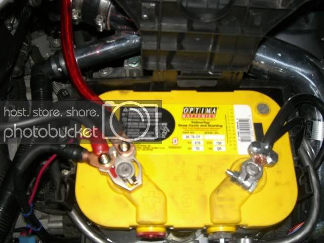

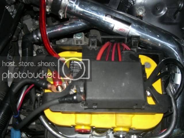

Well, got it done. Man, all the 1/0 gauge is a pain to work with. I used all coper connectors and solder, nothing but rock solid conections. I did the fulll big 3 and added an optima yellow top. Voltage is more stable and lights barely dim. Well worth it, but under the hood is very ugly at the battery.
I always liked to have a nice distirbution at the battery, but no stereo shop in town had connectors that tood 2 1/0 gauge, and 2 4 gauge for positive, so I just used copper connectors on the battery end too. Oh well, it was worth it.
I also fused the alt to bat wire with a circuit breaker really close to the battery.
I feel kind of stupid.... I have installed a few stereo systems, not a pro by any means, but pretty knowledgeable. I had NO idea that the negative terminal on the battery was smaller than the positive terminal! //content.invisioncic.com/y282845/emoticons/crying.gif.ec0ebefe590df0251476573bc49e46d8.gif DOn't ask how I learned, but lets just say it involved a couple of expensive battery connectors and in the end I used plain old nappa battery connectors that laying around in the shop I was doing this at. I had to hook one wire to hte top of the optima and one to the front. It works....
As you can see from the above pic, I need to do a little dremel work to get the plastic piece to fit right, it's still ugly though.....really ruins the beauty of the yellow top, but I was in a pinch and didn't have time to hunt down and order all the perfect battery connectors. They are speacial order due to all the connections, at least on the positive side.
The real beauty is in my trunk anyways. //content.invisioncic.com/y282845/emoticons/biggrin.gif.d71a5d36fcbab170f2364c9f2e3946cb.gif
