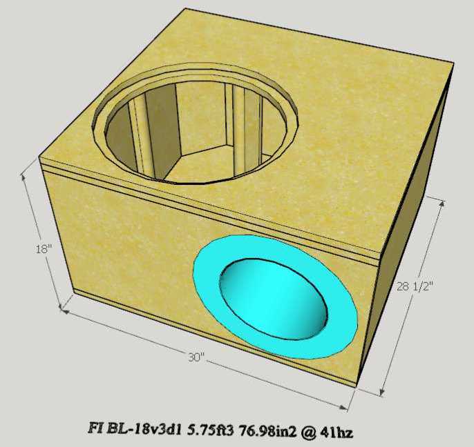

Holy Port!
I think I found my max volume to be able to burp at cabin frequency... around 6.2ft3 and this BL hangs barely. I'm just careless with this FI anymore and don't care, I'm gonna send it I think and soon... 151.85db without the aero tonight while testing, maybe I'll lose a touch of volume before I attend another event but once the Aero/RS 18 goes in there (redesign) I will be around 5.75ft3 with a spread of 35hz at 5.6ft3 or 5.9ft3 around 42hz depending on length.
The flare is big for sure...15.75" externally flared... I like it.
Should be a nice easy design, adjustable from 35hz to low 40's... time to get busy

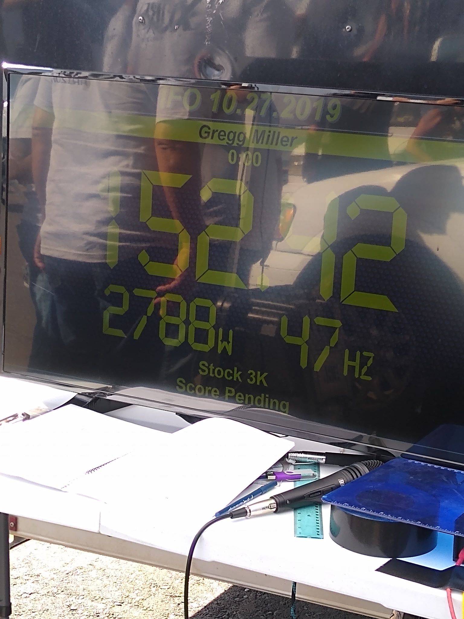

I screwed up and forgot to vent the cabin on the 1st run, it managed a152.2db sealed in the kick.
Time to test and tune now.

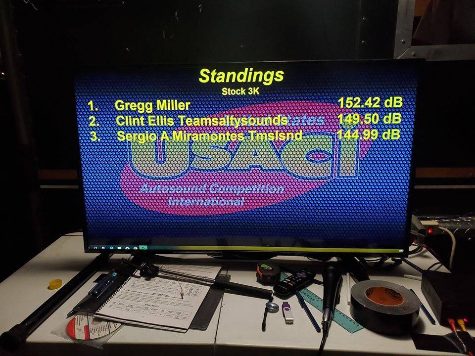

I changed tuning then forgot to sweep last event, 152.4db still... clamped 3500 watts in no wall 7k, 3k stock I managed a 151.6db 2915 watts clamped.
I feel it was pretty much plateaued with the Fi without a meter and a bunch of testing so...
