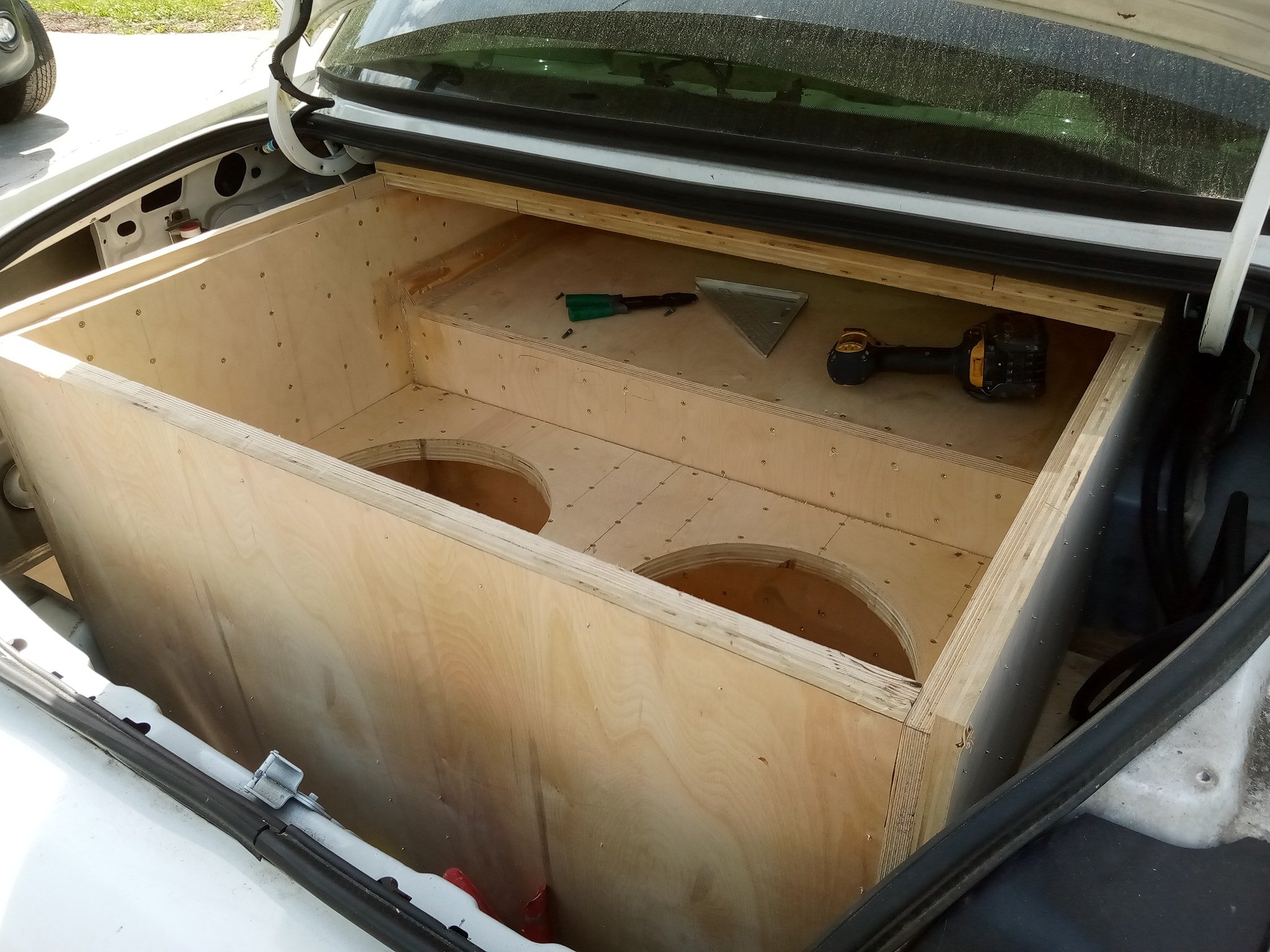

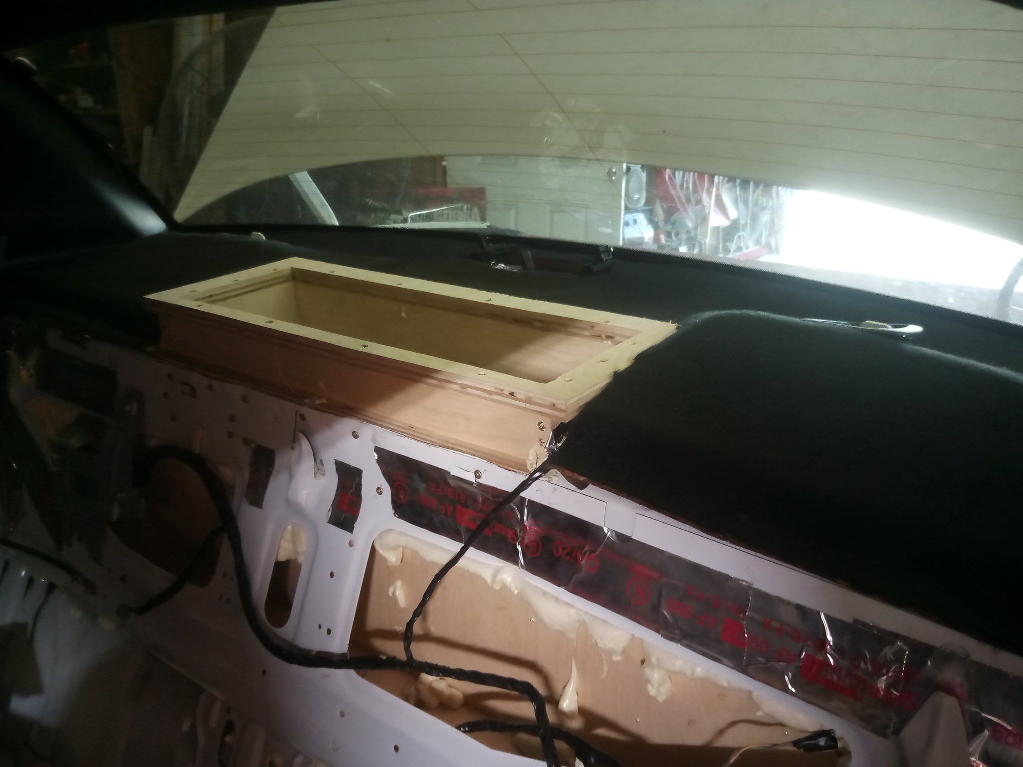

Good looking install popwarhomie. I need to take my back seats out this weekend to run all my wires & cables so I'll look for a way to maby do so.ething similar to what you did.

The pictures he shared is exactly the arrangement I did in a Town Car trunk many years ago (in a 1980 TC), I believe that the trunks of that body style have always been that general shape. You will find super thick sound deadening and steel everywhere between the trunk and the cabin once you get in there.
I will warn you that doing a build like in those pics is a lot of work and quite tricky. I would go as far as to say that just throwing away the back seats and doing a flat wall would probably be a less labor and time intensive build.
Good luck. Take your time! I love me some Lincolns.
