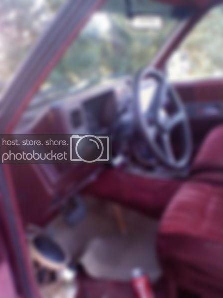

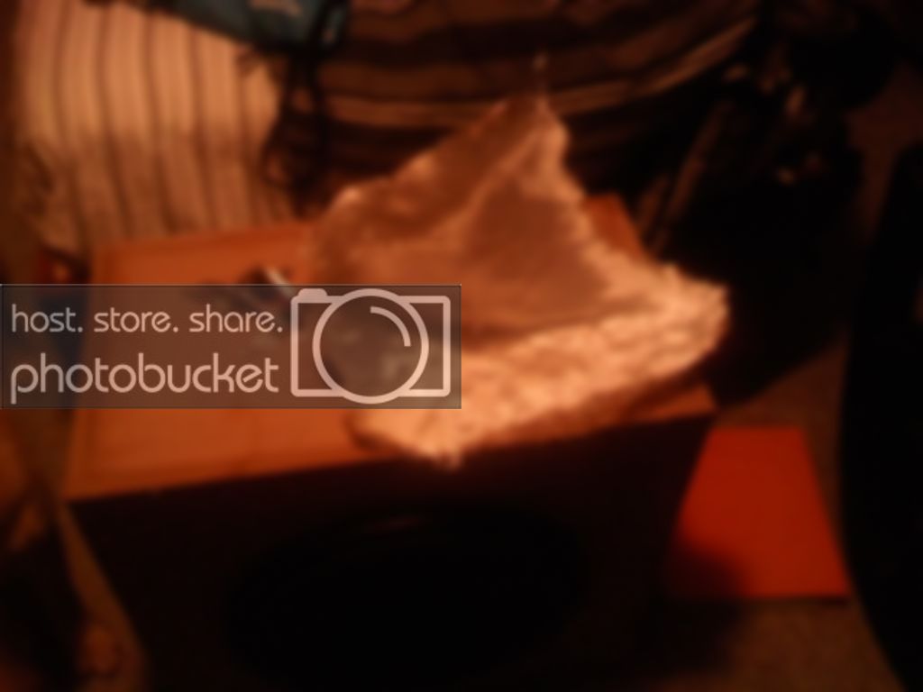

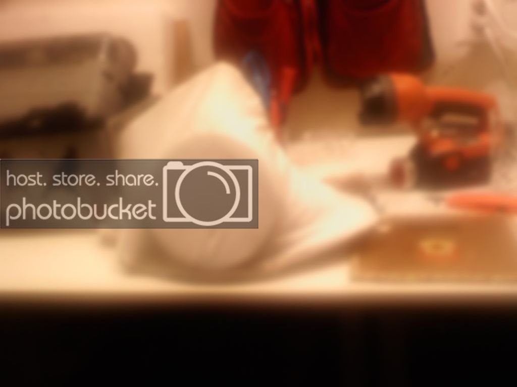

kick panels. I have fiberglassed and molded both corners and here are some pictures
this is not the angle I will be using I still have to figure out the imaging which im going to do today. this was also my first time fiberglassing so cut me some slack
This is the angle I came up with using a rod glued to the baffle for both sides but it seems to extreme as it leans to far back and points up to much.I pointed and glued thinking it was good. I emailed the pictures to cdt audio and they told me it looed "good" but I have to disagree I threw my speakers in some towels and angled them more like in their pictures on thier website and with no time alignment and the balance -1 on left side. I have all the sound being pretty centered I am not sure what to do to "raise" the sound stage as it seems to be coming from the front of the dash not on top and lacks some depth. This is what baffles me, I had the time alignment set for 51.4cm of delay for the left side to make it centered before i did the towel thing and when I changed the angles to more pointing at the opposites listener face the sound stage moved way to the far right and turning t/a sounded the best. I will be recreating the angles and use back strap or whatever it is called to get the angles the same. The tweeters I will aim for the rear view mirror. Any suggestions to make this sound awesome that will save me some time. I have read of the marking the window with tape 5 inches forward and 1.5' down from the listeners ear and aim for that for both tweeters and mid range speakers.

well ur off to a good start.. i would try shrinking the box down to around 2 cubes and see what that gives u ... also from the looks of the last picture u mid looks to be aimed at the ceiling..... speaker position is wht is going to give u good imaging i would try aiming the driver mid and tweet at the passenger headrest and the pasenger mid and tweet at the driver headrest....... as far as getting centered image u need to play with the T/A not the phase.. might help ur stage height to put the tweets in the A-pillars ... if u have anymore questions shoot me a PM
well I took the term aim at the rear view mirror/sunroof location to literally lol. that makes me feel that CDT audio's support doesnt want to help me, they should of been like wtf when they saw that rather then being like looks good. That is why The way I have it now aimed with towels ghetto I know, towards the opposite windows, sounds a lot better.
