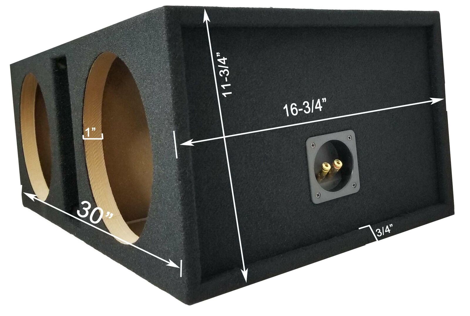

Id build an enclosure close to specs ported for those subs and give them some breathing room. Thats me
I have heard that Brahmas perform better in a ported enclosure but I am hesitant on dropping another $400 on a custom enclosure just to find that it still falls short of my expectations.
I think a ported enclosure towards tuning has always been closer to my expectations rather than sealed. Its been worth every penny spent. You can get a Glue and Screw tuned enclosure for less than $400 bucks from GP Audio
