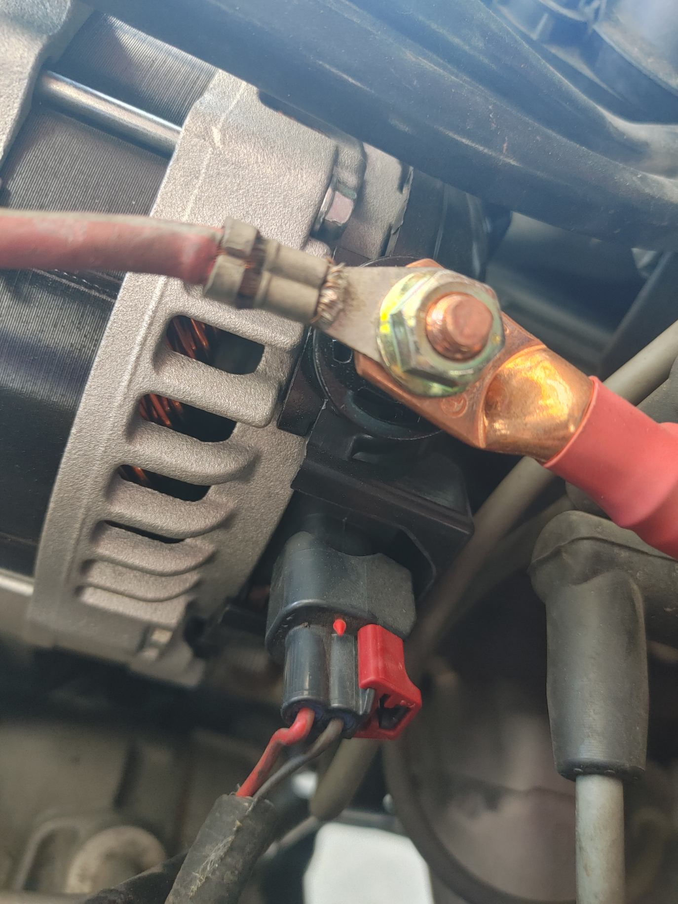

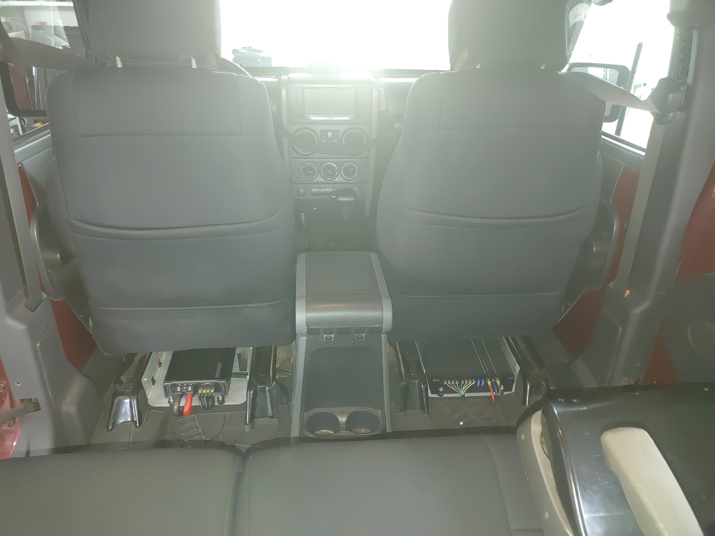

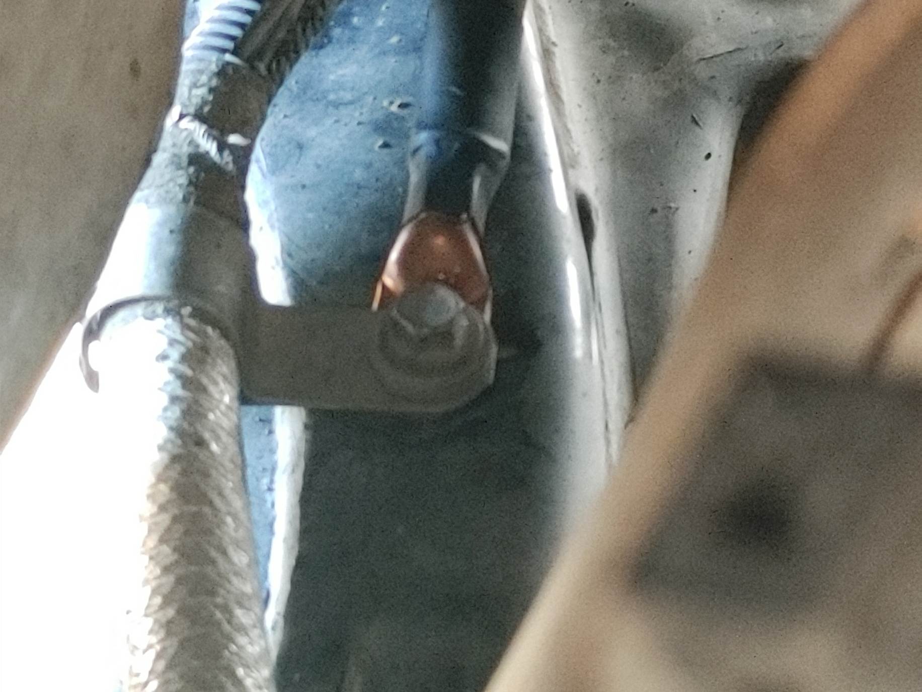

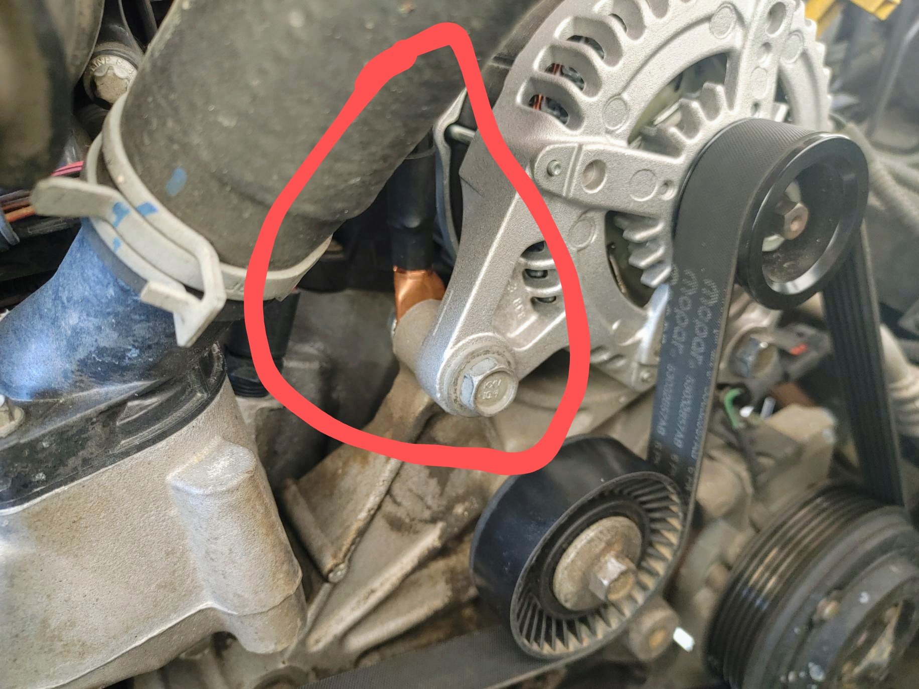

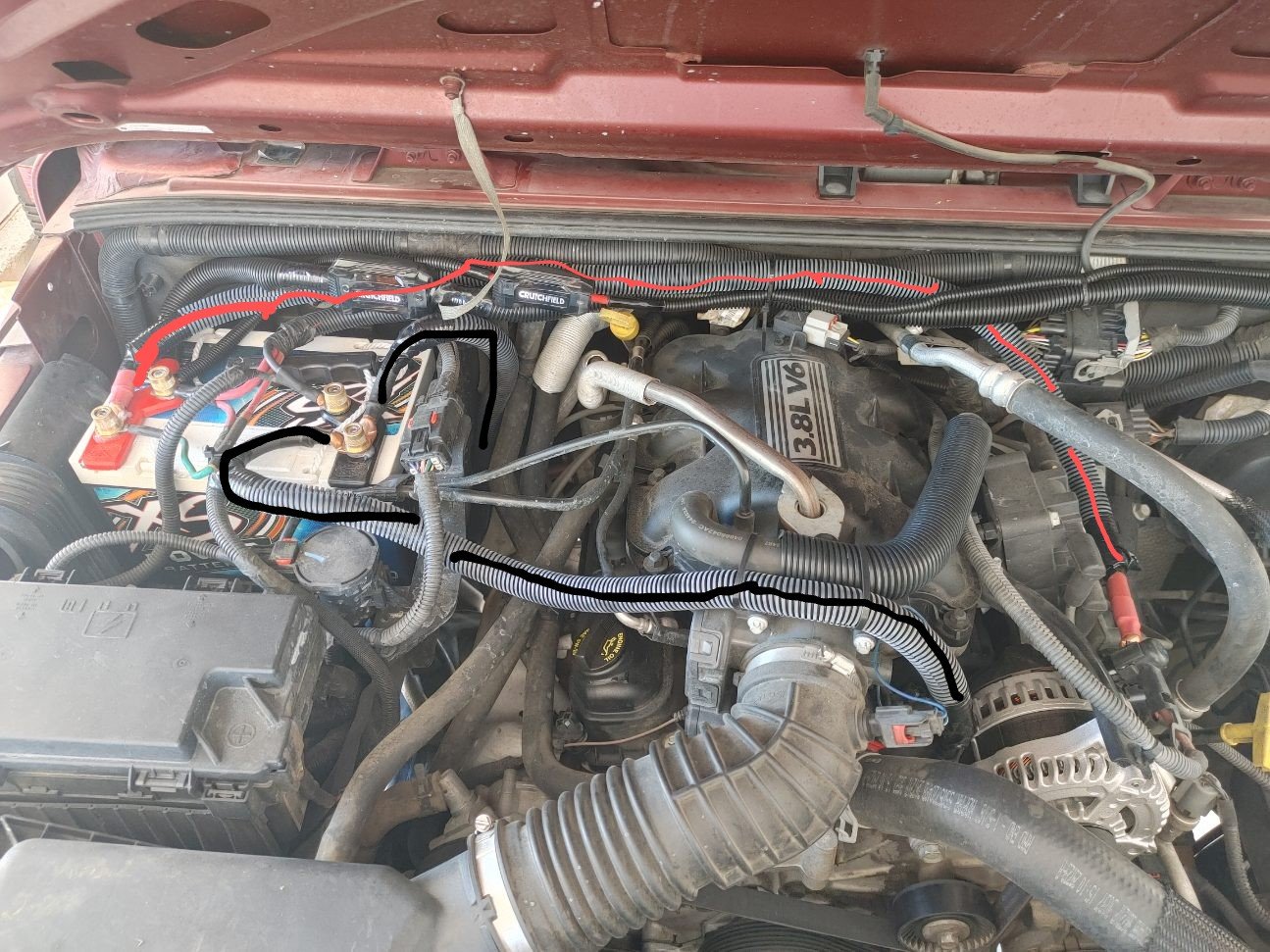

Ive been thinking about this and the shop that initially installed the big 3 and alternator did wire it differently than what i found on xs powers website.. He ran the alt/engine ground to the battery instead of the chassis and the battery ground is ran to the frame of the jeep, not the tub metal like where my amps are grounded.. Should i ground my engine/alt ground and the battery ground to the factory firewall grounds? My amps are grounded to factory ground points on the tub near the amps. Ill attach pics

Leave the ground to the alternator from the battery that is just fine, mine is run to the battery as well that is how it should be done. As far as the second ground goes mine is grounded to the bolt that the original ground was on and is basically bolted into the side of the front quarter panel. Also it looks like that one small 4 gauge wire from the positive alternator post is going to the fuse block like it does on mine? If so remove it and use 1/0 instead. I did so and was worth it. Those are usually corroded inside after a year or two vs a sealed connection like the other ones you have.
