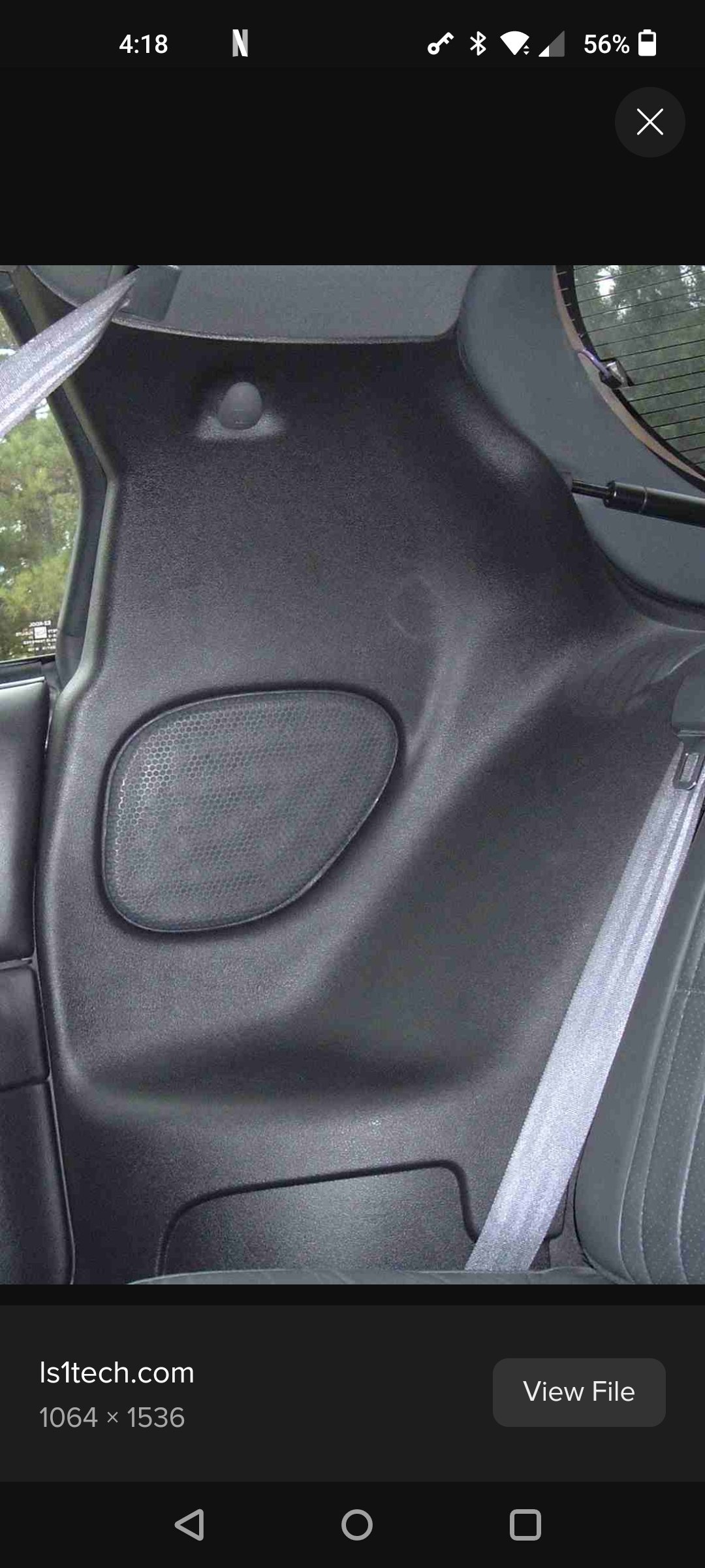

I have KICKER 47KSC6504 6.5 Inch speakers in the passenger sail pannel.
This is new info and confusing. You have 6.5 spekers in the door sail? The little triangle that covers the side mirror nuts?

Camaro guys refer to the sail pannel to reference the area right next to the passenger (I guess that isn't the proper term?)
