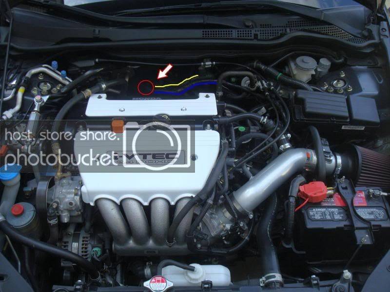

Not sure if the 06-07 have the same grommets as 03 - 05. I have an 05 and this is the grommet I used. It was the easiest to access IMO. The wire under the yellow line is my power wire covered in a wire cover thing. The wires above the blue line, is a factory harness(be very cautious not to cut any of these if you choose this wiring location). Sorry for the dark pic. If you need a better one let me know and I can try to get one. The wire comes out right under the passenger dash. I just ran it under the floor mat, under the passenger seat, under the rear floor mat, under the rear seat, and into the trunk.
