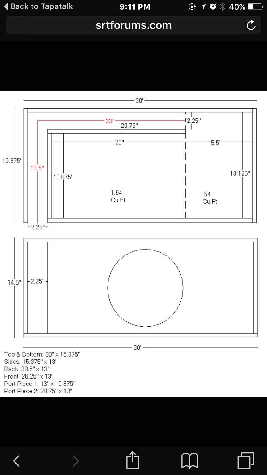

I made the 2.0 cube at 31hz found on the basic box ideas on this forum for a pioneer 12" champion pro series sub. The sub is on a alpine MRX-m1000 1000 rms mono block alpine and the sub is wired to 2 ohms, the sub is 1000rms as well and 3500 watts peak The volume seems to go to a certain level max and then it simply sounds worse after, that seems to be the sweet spot. I raised the gain to see if maybe it needed more power and it reaches the sweet spot at a lower level of 20 so sooner but then drops or rolls of at about 23, the HU maxes at 35 so I still have plenty of room. Could my port be to long? Would cutting it shorter help??

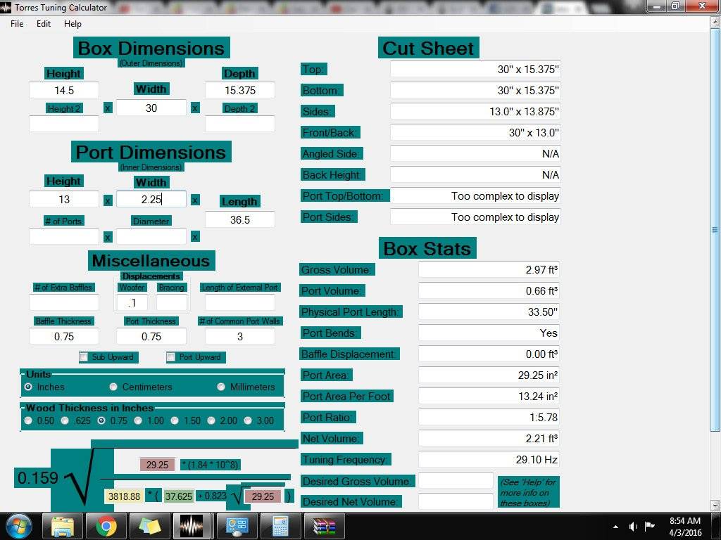

It's prly the port. Your box is 1.70cubes tuned to 29hz with 18" of port per....
Could be I suppose , the print states 31hz and 2.0c , so what can I do to resolve this? Cutting the port back? If so, how much ??
They way u describe it not getting louder is either your maxing your amp out... Wired to 2ohm your prly rising to like 5-6phm and hardly making power... Or you could have to much port and your not building any pressure and it's just like free airing after a certain point.
I guess I could tune it and just let it do what it should but still feel that I should get a little more out of this sub and just wonder if the box is the culprit.
