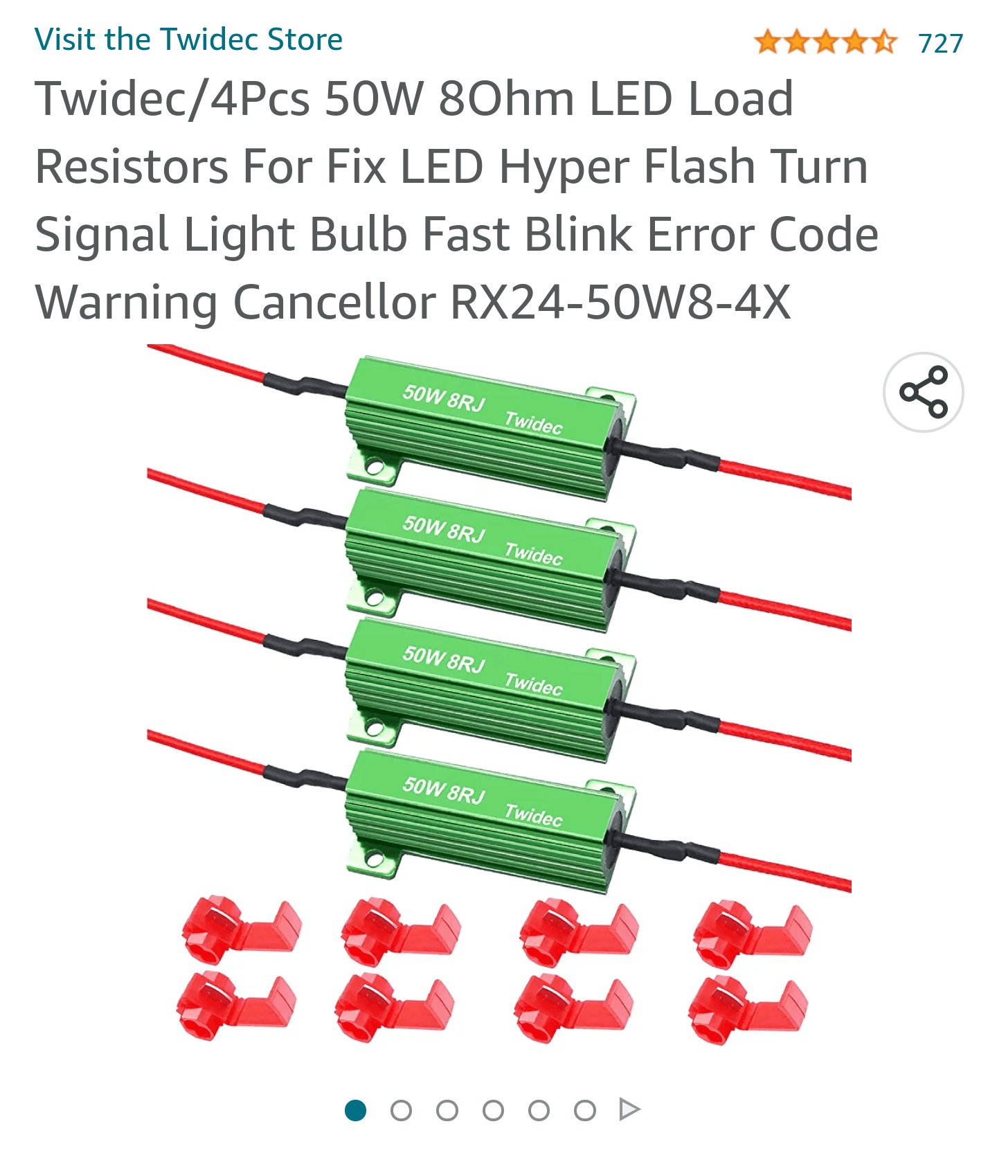

It has no effect on audio quality. I use these load resistors parallel on the radio out.
Interesting, I suppose it would act like a speaker in parallel. What about using a higher ohm value to so I don't have to dissipate the heat of so many watts? By ohms law 40w 12v 4ohhm speakers. But if you had a 16 ohm speaker @12v you would have only approximately 10w.
You could try a higher ohm value, but nobody knows what value will kick on the outputs, so you'll be experimenting. I guess you could get 4x4ohm loads and wire in them in series and see if that works. If it doesn't you can keep pulling resistors until it does work.
I never thought about that. I have not even pondered to feel the resistors. Maybe like Jimi77 stated, the radio may assume the higher resistance as a speaker failure and not kick on.
