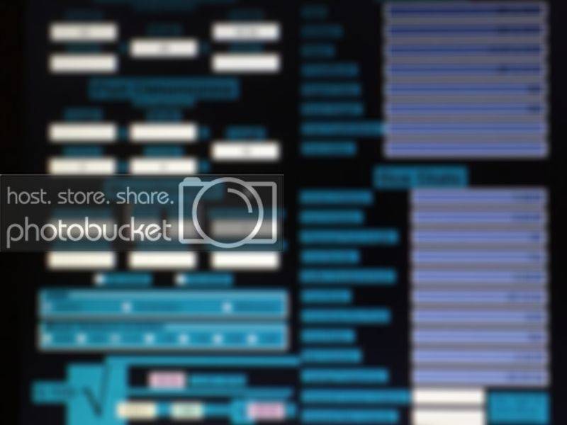

If you can recommend a flared port size and length it would be awesome also since all 3 calculators show different and since the power is up there port size will change
Im going to be making my own port again and both ends will flare.
Thank You guys very much!
Rich

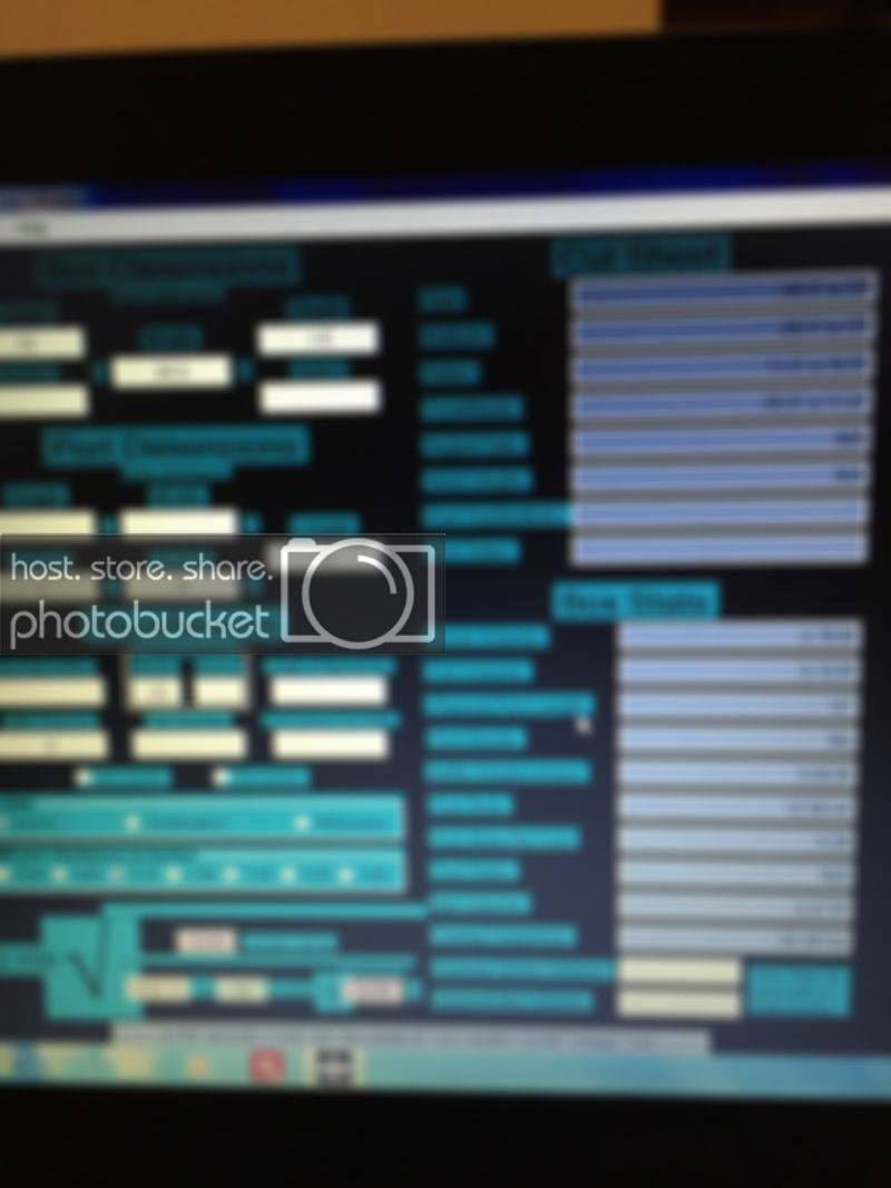

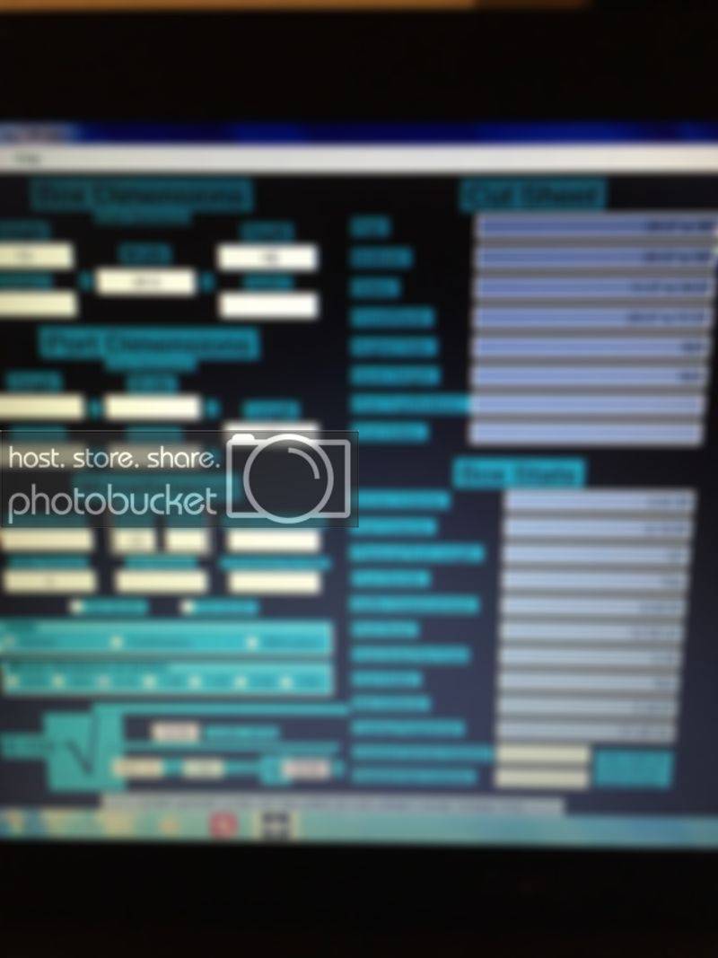

a few calculations I did but the port area is a bit small I think . SA says 16 but a 4'' port yields 12. A 5'' is way over at 20.

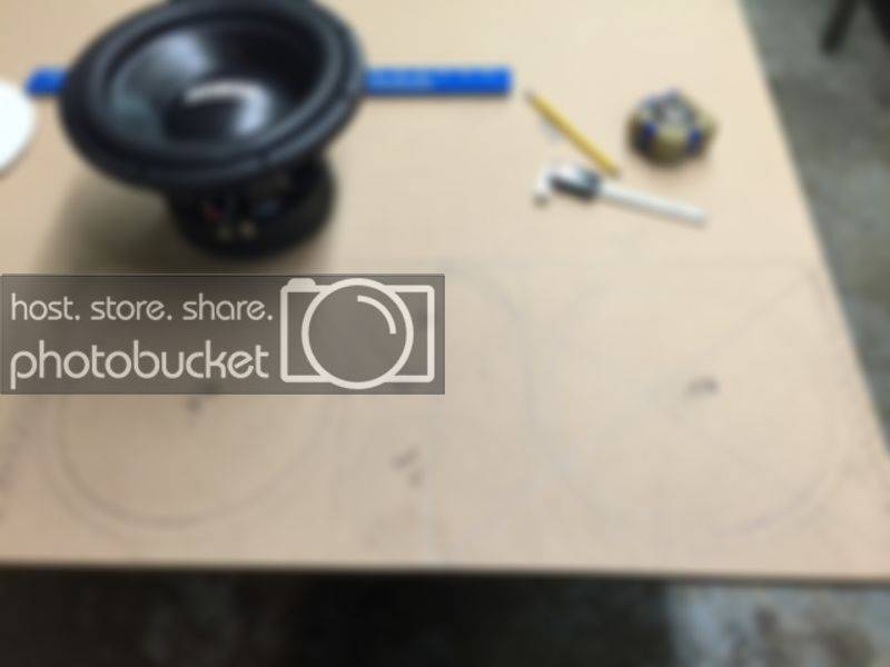

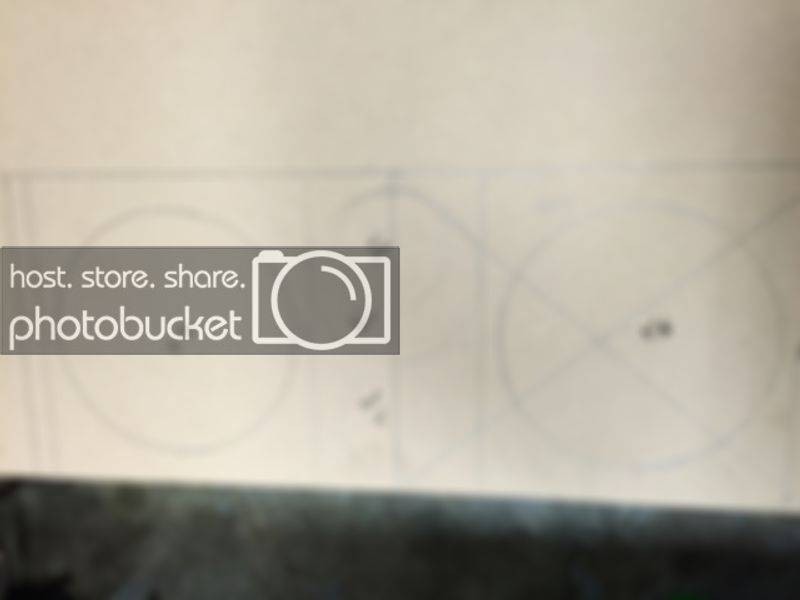

Ok, this looks better. Running out of room on the front baffle so I think im going to go with 2 4" ports. you can see the sketch on the mdf vs the 6'' port.
What 10's? Port per looks decent on the last pic. Make sure you add in port thickness and bracing if any.

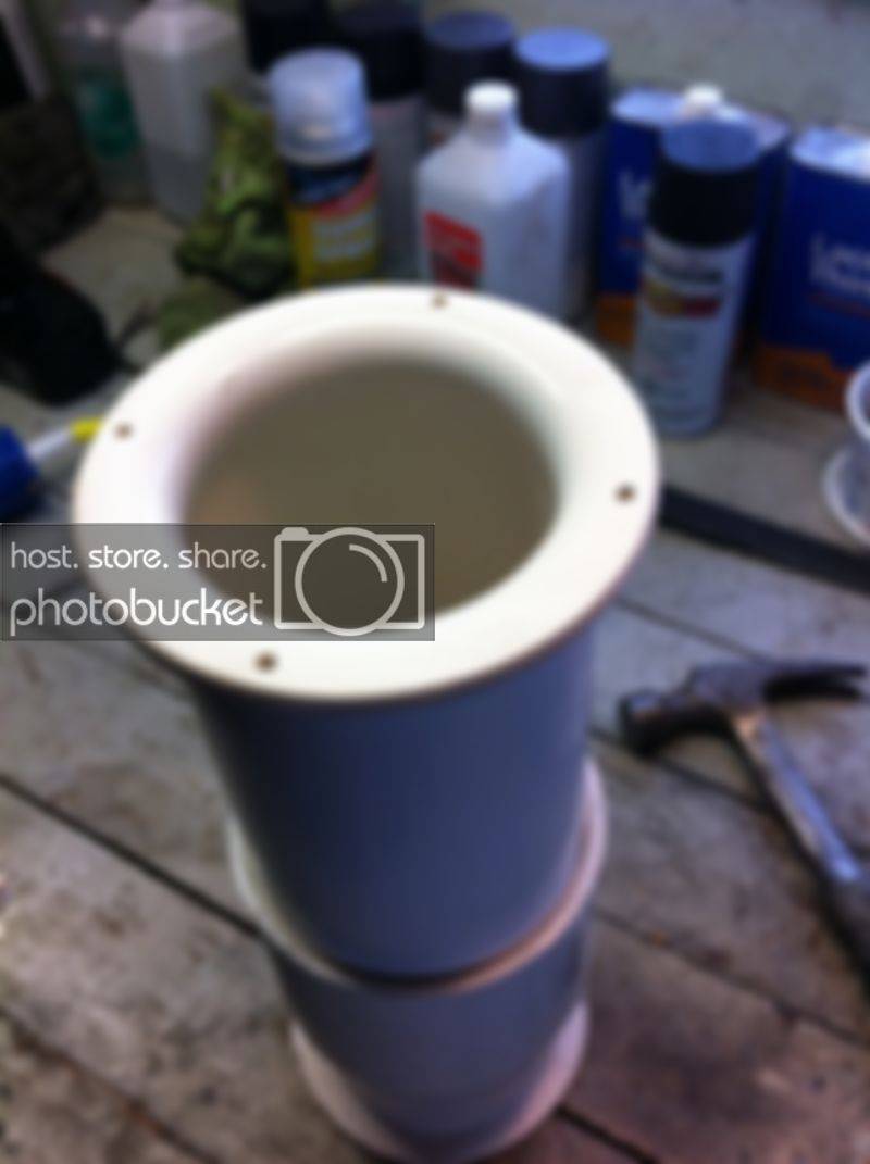

sorry for the delay, I tried to reply from my phone a few times today but kept getting errors. Im going with SA E10 D4 subs wired to 1 ohm Maybe 500-700 rms to each. Still trying to play with the numbers. Really would like to get the net volumn to 2.5 cuft. I picked up some 1/8'' thin wall sewer pvc pipe today. Its 4'' diameter. What king of volume do you think is takin up for 2 of them 16" long. And maybe 3-4 feet of 3/4 dowel rod
What's the pvc pipe for? Hopefully not your new box because the port can be incorporated utlizing part of the box. Or an aeroport would help too.
Those PVC pipes are so old school!
The aero kits are like 30$ X2. Im gonna make them for 12$ total
Nice. Make sure you got room for those flange lips....they don't interfere with anything else.
