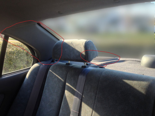

Here's the rear deck area. You can see where the 6x9 is mounted. I've also highlighted a plastic covering (on the D pillar?) where I thought a tweeter could go, but there might be just metal beneath it.

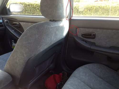

Here you can see the front and rear doors. I don't know if I could stick a tweeter in the back door similar to where it is in the front without running into just metal. There's also a plastic covering on the B pillar where it could probably go.
Would these locations work? Are they too much work with too little benefit?

I need to check tomorrow, but I feel as if there should be enough room before hitting metal to flush mount it in the circled location in the back door.
