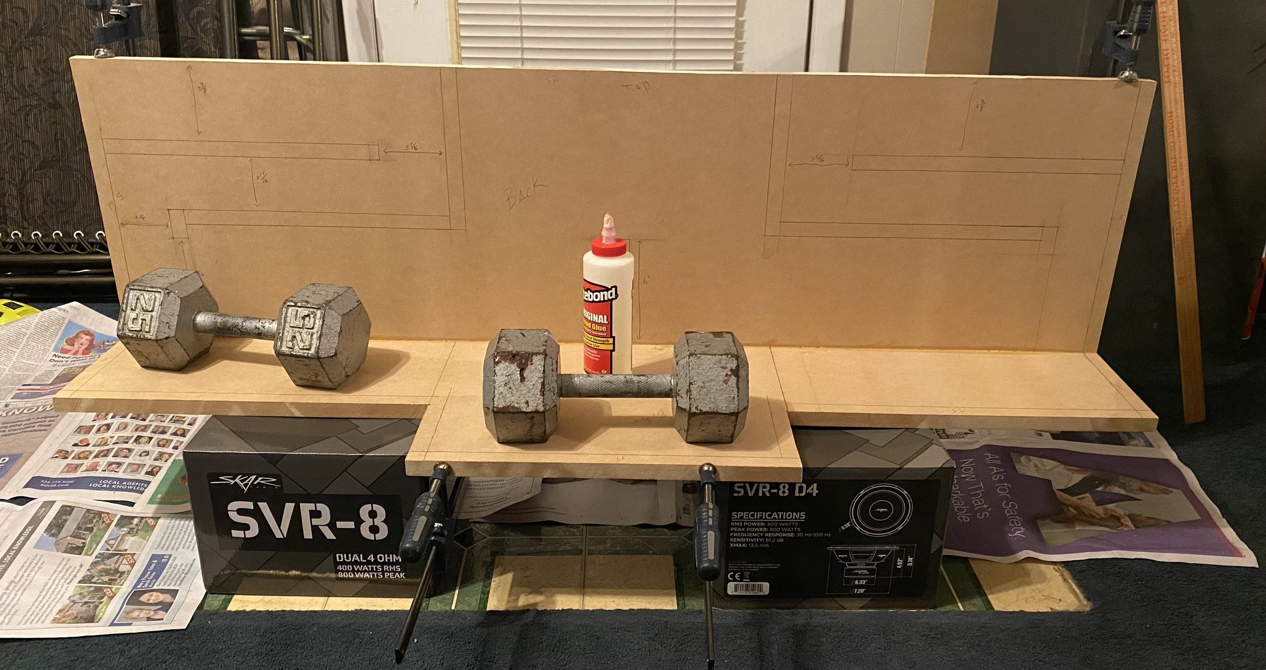

Early stages but I was bored and decided to cut a couple pieces today. Sub is on back order til Jan/Feb. Gives me time to just take this build slow and no rush.
Box will be in 1996 f150. Left and right sides behind seats with sub facing foward between bucket seats.
1.5@32hz

I hope this box and it's somewhat unique layout work out well for you. Getting these single cabs sounding good and still having leg room can be a challenge. I tried really hard to make this the absolute best that I could. Every clearance is just so tight, and volume is limited behind the seats. That's why your ports wound up that way. You can't really do a single side firing port when the box is shape that way. With all of that said, the internal flow of this box is unique compared to many other ported boxes. All done in the name of internal/back of the cone loading.

Stereo integrity sub teamed up with you on the box design, should be a win for sure! It’s funny cause right when I think you and I are cool, you got me with another design that consist of multiple angled cuts 😡🖕🏽!!😂
All good, just making me better at this box building. I am checking all Black Friday deals for a miter saw.

That was the best way to do it, I swear. It was really the only way to do it, IMO, where it has the best chance of sounding the best.
