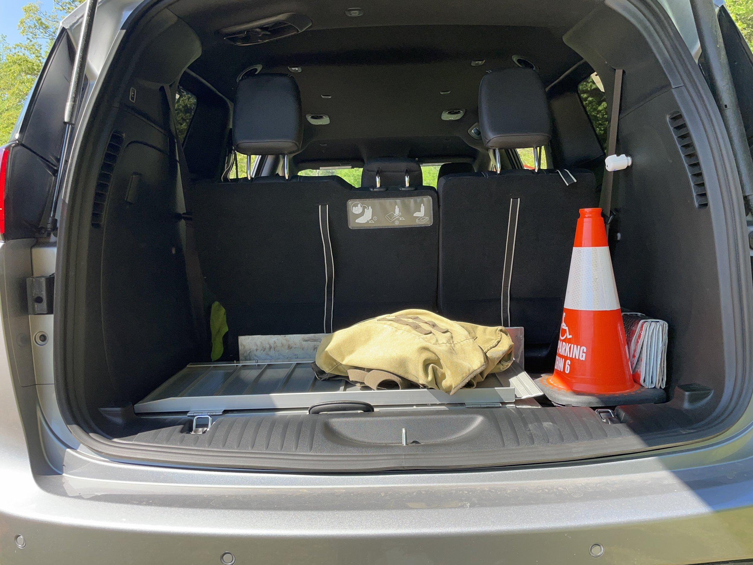

I'm limited for space so I'm looking at pushing one 10 with 500w. I always had sealed boxes in the 90's but even though it's a larger box I'm considering a ported one this time.

I have 48in wall to wall and 16in from the seat to door to work with.
