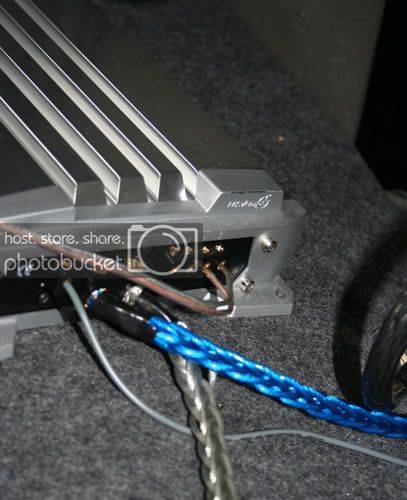

So, in a quick run-down of what Nutz did wrong/****ed up:
- Painted sheet metal in trunk as ground, with wood screws (which damaged my amp's transistors)
- Braided wire used in conjunction with 1/0 when 1/0 should have been used for a 1.5-1.7kw system
- Power wire under hood fell out of fuse block, wasn't secured by the screw at all
- Grounds under hood not upgraded
- Car was left a mess
- Rear door panels have small 'cuts' all over them
Not to mention that as me and my previous boss watched them install my 12s (they were almost done when we showed up), the dude blew about 4 fuses in my car.
NOW the issue is that Nutz is coming on the internet attempting to defend his 'reputation' and lie, lie lie about what exactly happened. He knows he cannot prove that he didn't **** up as I have pictures to prove he did...so he sits there and attempts to draw the attention away from the TRUE issues as i have listed above and whines about my stock alternator dropping voltage - which COULD have been why the capacitor in the amp was bad, and i take blame for that, but the issues i listed are still Nutz' fault. As a returning customer i should have been issued a full refund on the install labor, and asked how else could they help.
Instead i was told i was an idiot, i don't know what i'm talking about, i believed my "Internet Buddies" over him (he was reffering to people on caraudio.com and roe) even when i said some of these people have systems pushing 40,000 watts.
He will continue to lie and attempt to get the attention off of his **** ups, but the truth of the matter is they ****ed up, won't admit to it and keep trying to take the attention off what they did. Nutz, you can continue having your buddies sign up and post here in your defense, but pictures don't lie. STFU.
Nutz power wire job:
Also, not to mention that after i posted here negatively reviewing Nutz' shop, he threatened to SUE me for libel and slander. SUE a customer because they reviewed your shop negatively when you damaged their equipment and screwed up their install..hmm..
