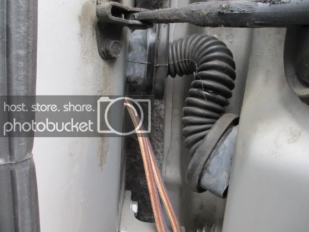

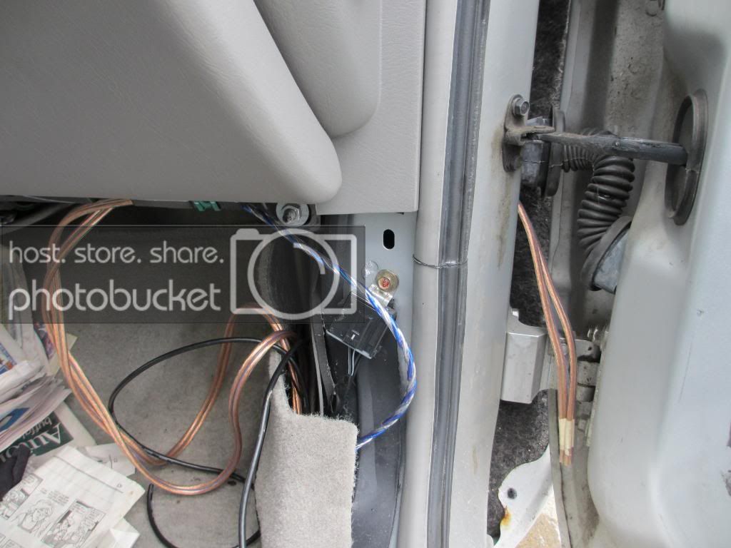

speaker wiring can be run through the doors and into the car with the factory "Wet boot" which is simply that flexible rubber tube running from the car to the door.
on my car it looks like the following:
running wires through this isn't exactly an easy task but its what needs to be done //content.invisioncic.com/y282845/emoticons/smile.gif.1ebc41e1811405b213edfc4622c41e27.gif You essentially pop the wet boot off both sides, run your wires, and pop it back in. Again, easier said than done, especially because the e-brake assembly might be in the way on the drivers side depending on where it is.
