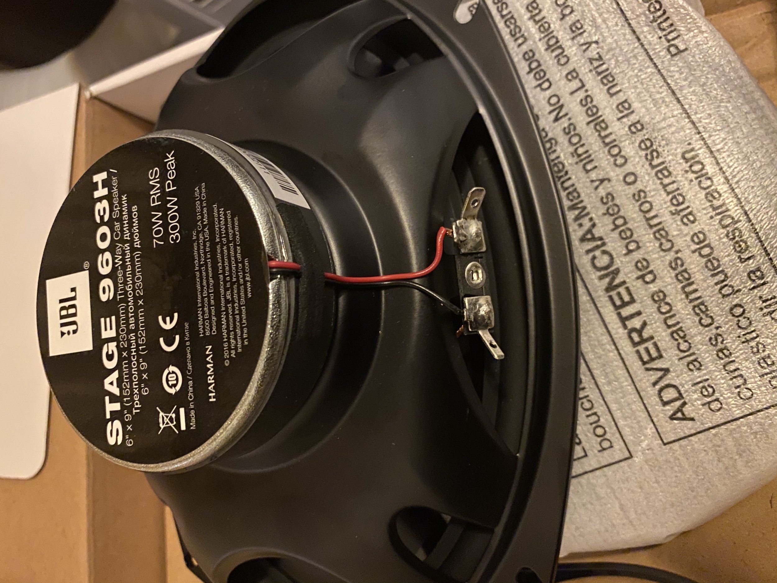

My 6x9’s run 70w rms (300w peak)

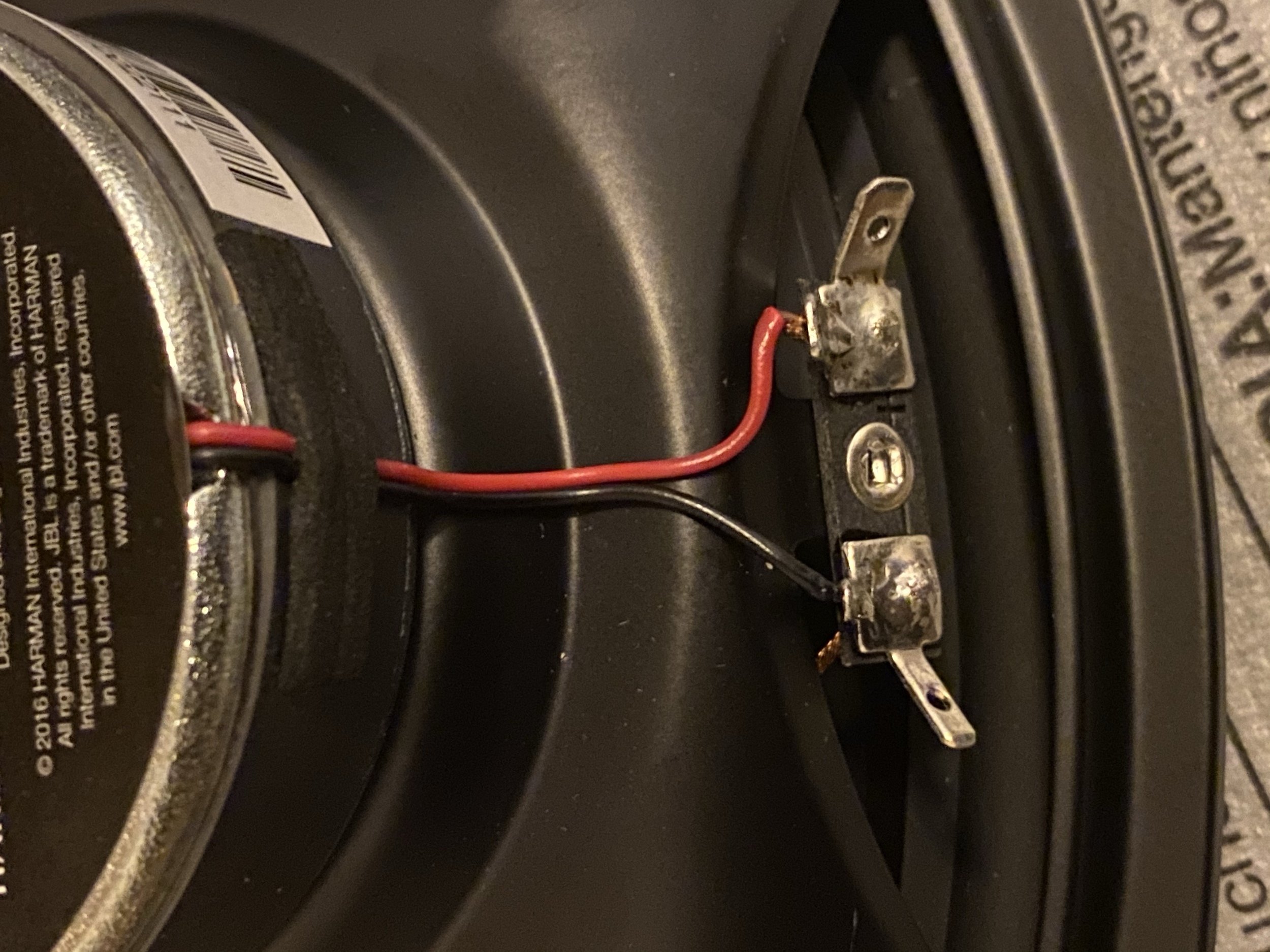

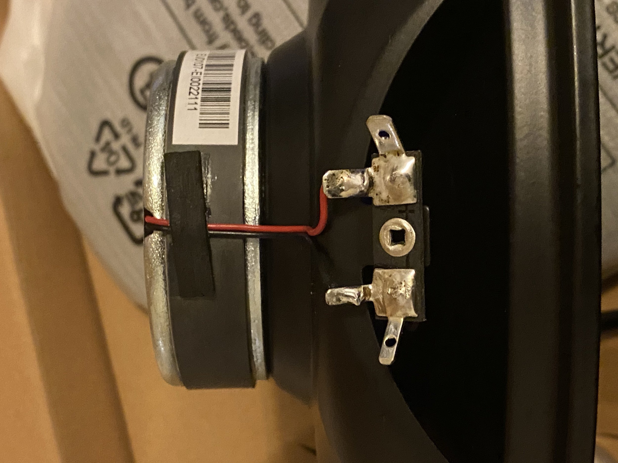

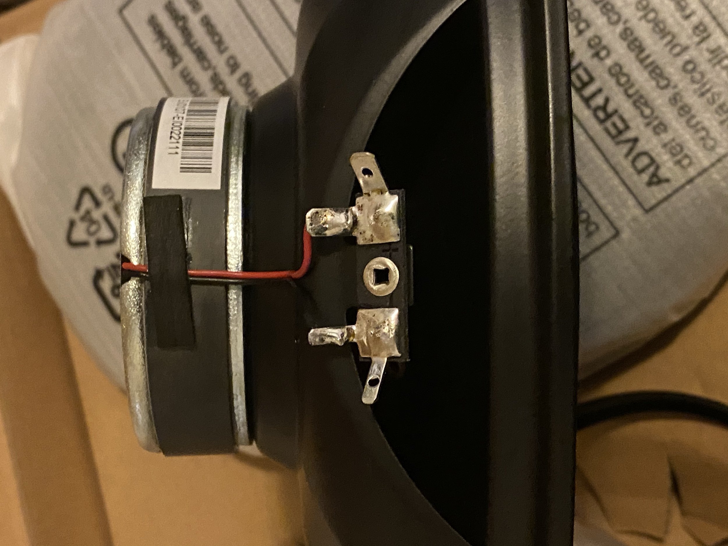

my next issue is wiring my 4ohm 6x9’s to make a 2ohm load for each pair. I know I’d have to parallel them but the issue is that the negative and positive are already soldered (photos below). I don’t know how i need to wire them with the speaker wire to connect them to the amp because I’m not using the factory harness. I’m new to car audio and this is my first project which is why I run into so many issues. I just want to have everything in order before I take anything apart.

As it relates to your second issue, not sure why you would be concerned about the speaker's terminals already being wired positive and negative. Speaker wire - Positive to positive and negative to negative. See diagram.
