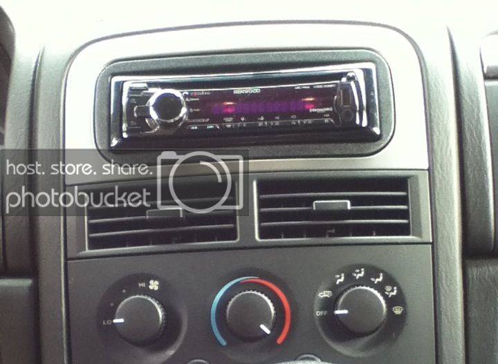

Kenwood KDC-X397

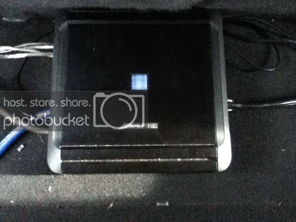

Alpine MRV-M500

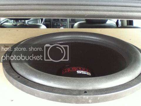

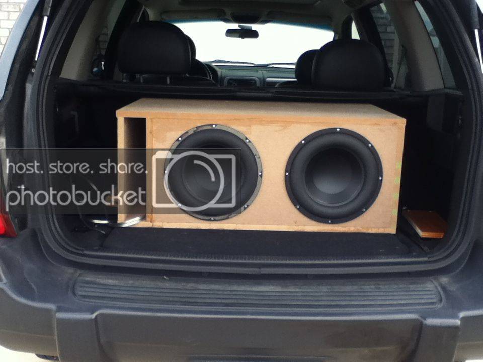

2 Polk audio PSW 505 12's... (Temporary!)

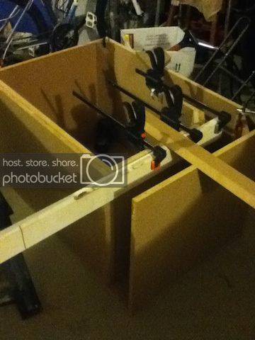

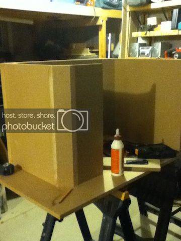

4 cubic ft enclosure tuned to 32hz

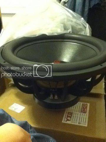

SSA Xcon 18 //content.invisioncic.com/y282845/emoticons/woot.gif.aaa6090e619a97b6090d16dd863c5a69.gif

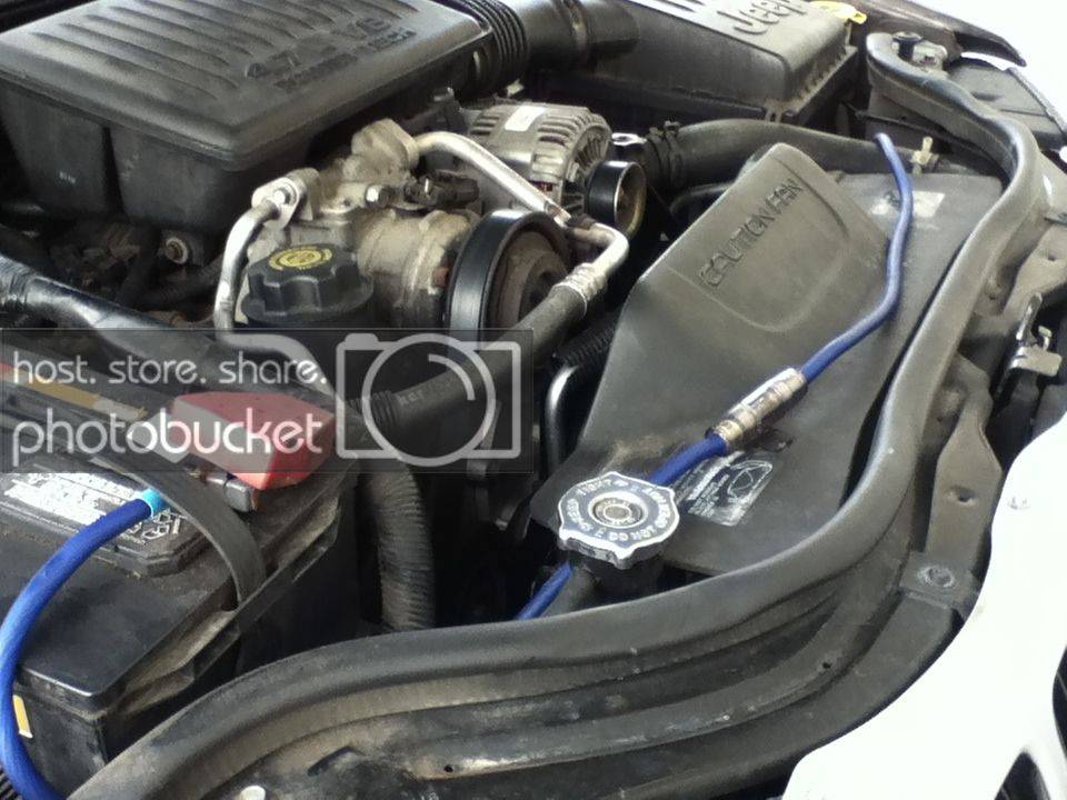

The Newish to me jeep
Power run
Head unit installed

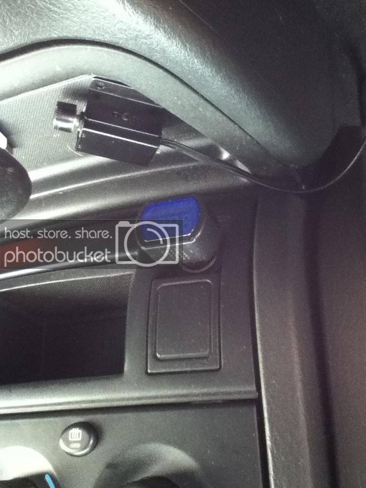

Cheap *** Volt meter and amp remote
Tiny amp

Oh no a high school speed build... ha just kidding man, sounds fun. Keep the pictures coming when you can

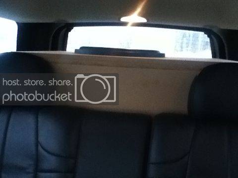

They are .. meh.. better sounding than walmart crap but i wouldn't pay for them. They do get pretty low thought, 27 hz flops sunroof and all doors. The big downfall is the efficiency is fairly low compared to other woofers in the same class.
dam those home audio subs look decent. I bet with some power they'd be decent. Looks good so far.
If I may throw you a tip:
Get that fuse as close to your battery as possible when you run your new wire. it's the only thing protecting your car from burning to the ground if some should ever happen. //content.invisioncic.com/y282845/emoticons/smile.gif.1ebc41e1811405b213edfc4622c41e27.gif

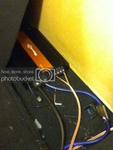

Small update
Crescendo amp came in. Have subsonic set at 10z because anything above cuts out my 27 hz.. maybe I'm just down syndrome..

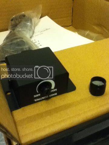

and bass knob was broken in the box....
Installed with my 4 gauge with 80 amp fuse. running 4 ohms till welding cable comes in.
