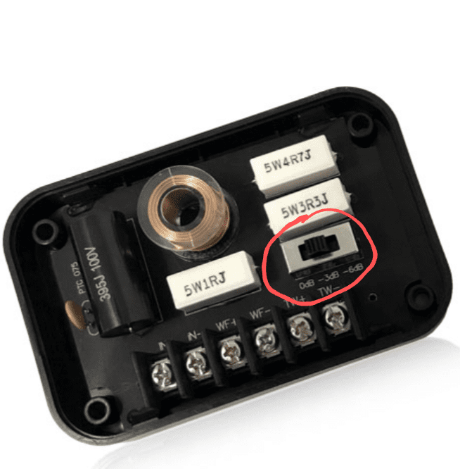

Pop open the crossover module and try the -3 and -6db switches and see if that doesn't tame things a little. I'd also think you can turn down the crossovers on your amp some. 120hz is too high. Play some bass heavy music and turn those down slowly and either watch the cones or listen for signs of mechanical stress on the low notes then turn it back up a touch after you've reached that point.
where are the cross over modules located ??
