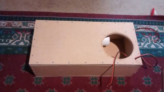

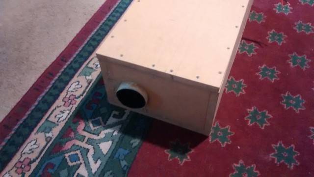

This box dosnt allow the driver to dig deep at all, lots of port noise. Its .74 net @ 33.5Hz according to TC Sounds cal app, 10sqin of port via a 3in aero. Anyone know why it dosnt sound right?
Box is 12x8x25 - port is 3in @ 22in long with 1in external length. Seeing about 600wrms from a kicker 750.1

That box looks horrible. I can only imagine how it sounds. I stopped using circle/aeroports when slot ports became the norm and never looked back. Port noise galore with any circle port other than an actual Aeroport branded port, they're not as bad as PVC tubing but the port noise is still there. Go slot port if you don't want port noise and tune the box lower.

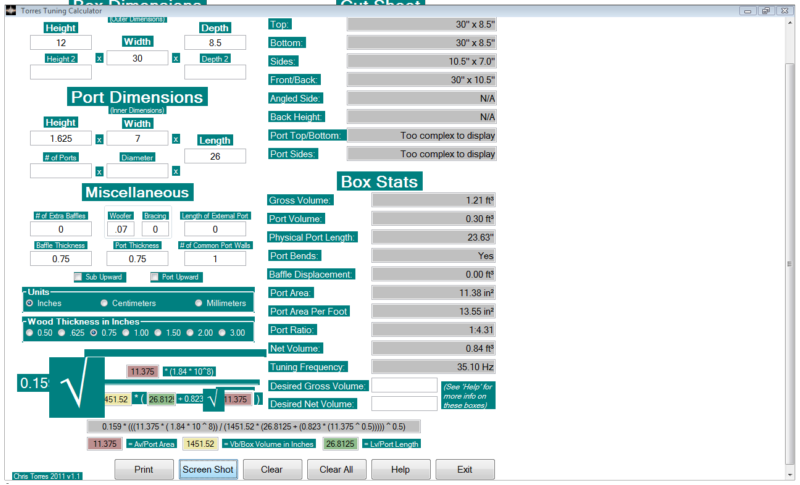

Hows this look? Box sits behind drivers seat and center console. Sub will go behind center console as low as possible port will fire out the side towards passenger seat above sub. Will be a strait port
Just got an email back from tantric, .75 net @ 35 w/ 8sqin of port. But i know that cant be right or else the box above would sound fine @ 10sqin of port.
Looks like port opening is too close to the back of the sub so it's unloading
What's the rule of thumb on distance port to sub? Might try to cut it shorter. Maybe go 35-36hz lose a few inches
If I cut 3in off I'm at 35.5hz and 9.5sqin of port
